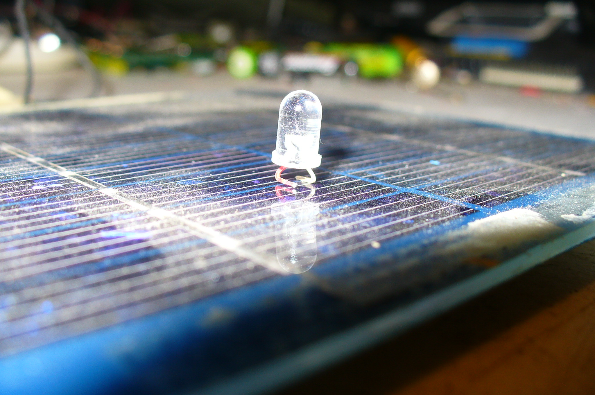

Is there a preferred method to surface mount radial components by shaping the leads on a way that will somewhat keep them upright for reflow soldering ?
Say a 5mm electrolytic, or a led, meant for trough hole... how to 'convert' them into useable for automated placement surface mounting ?
Do you know of examples, pictures, lead cutting/bending machinery ?
Perhaps something like this : P1010251.JPG
Better suggestions, please ?
Externet, something like what you've shown can be used for radial caps as well. Because of the bulk of the component, the solder paste won't be able to hold it in place if the board is bumped before reflow; you can use a small amount of glue under the device to accomplish this.

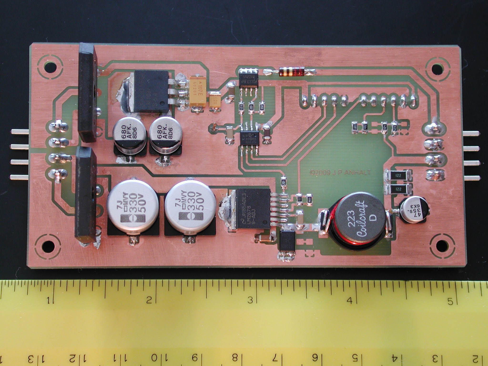

Something to consider is to solder through-hole components on the top side. If you want reinforcement, you can etch a small pad on the reverse side.
Here is an example I made several years ago. The large bridge rectifiers on the left are though hole; the rest of the components are surface mount.
On a single sided board, just solder the top side as close to the board as practical. Be sure there is a little extra solder. Then heat the lead from below and push the top-mounted TH component into place.

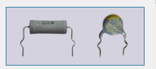

I have hand soldered through hole components to surface mount pads in the past, but this is hand soldering. I have been the leads 90 degrees from the body, then bent another 90 degrees a ways down the lead length until they were parallel with the body. This gave me a way to solder them to the top of the board and get a good solder joint with no problems.
Again though, this was hand soldering. Flow soldering would be different because the parts have to be held in place and in the case of something like resistors, they have to be held upright too. If the leads are bent slightly outward like your picture shows, they might stay upright but they are still too vulnerable to movement by the slightest vibration or even the solder itself as it passes over.
