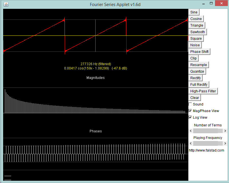

Your PC can generate 0 to >270 kHz with software. ( enable Tone and Log display) then draw wave or select any waveform. select max playing f and max terms. Java based arbitrary waveform generator , or arbitrary spectrum with draw of std. wave form
https://www.falstad.com/fourier/ Each button selects a wave or processes existing wave ( e.g. High pass , rectify etc.
Then Audacity has Sweep Generator and Mic input record. or Speaker and Aux in., with Analyze Fourier spectrum, etc. use it as a sig gen, scope and spectrum analyzer/

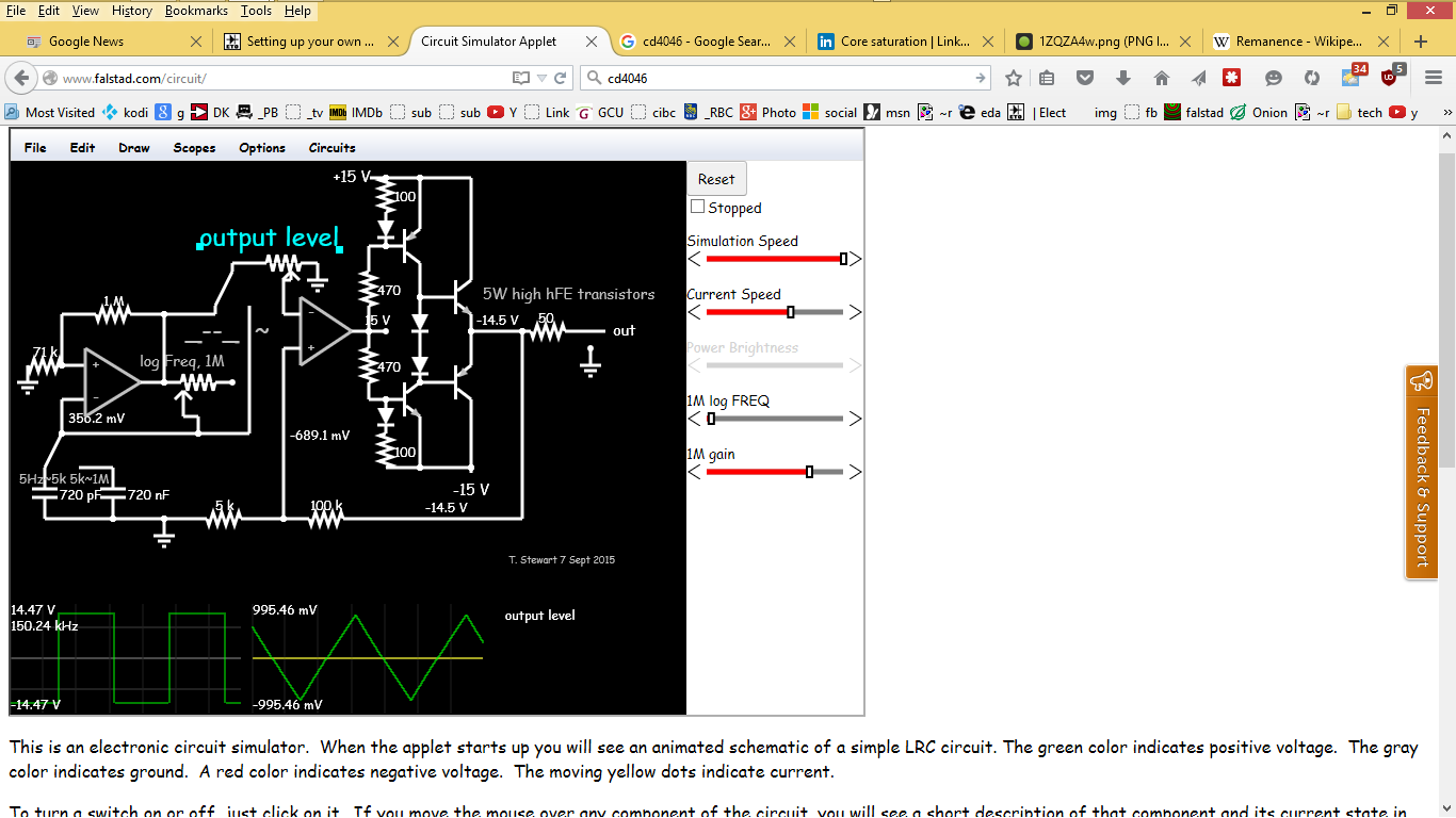

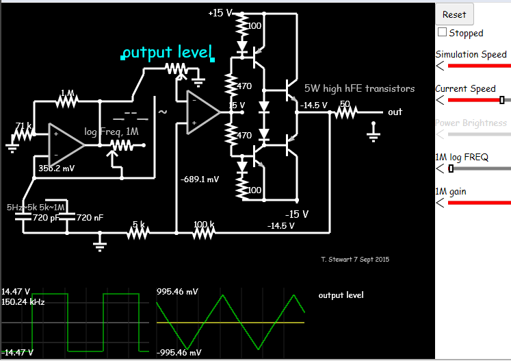

You can also use a CD4046 PLL which has a VCO that spans up to 2MHz or more at 15Vdc with by R or C selection.
using counters to scale many decades with precision.
Or you can make your own sine gen
Or a FM sweep gen
Or just a simple Triangle, Square wave gen.
adjust cap for 20Hz ~20kHz
