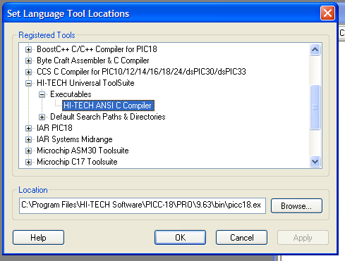

N Nick' New Member Sep 17, 2009 #1 How to set locations path to C:\Program Files\HI-TECH Software\PICC\std\9.60\bin\picc.exe for compilerr, assembler and linker? I am new to MPLAB, please help. I have a PIC C compiler and would like to add those into MPLAB.

P Pommie Well-Known Member Most Helpful Member Sep 17, 2009 #2 Hi Tech C should have asked during installation if you wanted to integrate with MPLAB. You can set it up manually under Project->Set Language Tool Locations. See attached. Mike. Attachments Tools.png 19 KB · Views: 451

N Nick' New Member Sep 17, 2009 #3 Once i have the hi-tech compiler, do i need the CCS PCB C compiler too?
P Pommie Well-Known Member Most Helpful Member Sep 17, 2009 #4 To can install as many compilers as you wish. Installing the HiTech complier should be all you need to get started. Mike.
