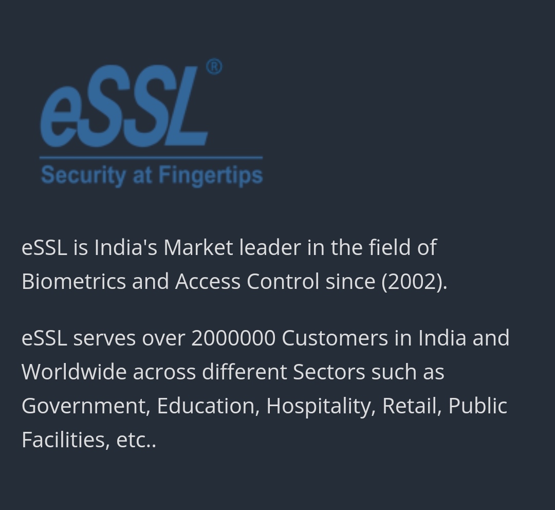

Please see the screenshot, What are they mentioning about the server in the given link?
There is no mention of (internet) Servers anywhere I can find??
"eSSL serves over 2000000 Customers", "Services", "Repair and service centre"
It's all "Customer service" type references; boasting the number of customers using their products, and how to get help or repairs.
[eg. When you buy something in a shop, you are a customer or "client" and the person that serves you is a "server" and provides a service; computer/internet terminology is adopted from that, for the computers or devices that use and provide facilities respectively - but in a totally separate and unrelated context, just typical re-use of older words for newer concepts).

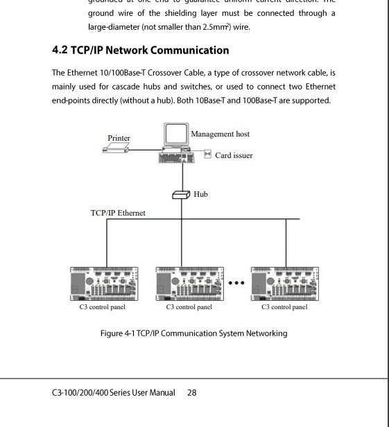

From one of the device user manuals in the linked page: A network diagram - all local Ethernet, just using a PC on the network for configuration of the units and reading logs etc.
Everything is local to the customer; there is no centralised system or server at the manufacturers site that they connect to.
It's just as I said a control / monitoring setup should be in my previous post, purely on the end users site.
