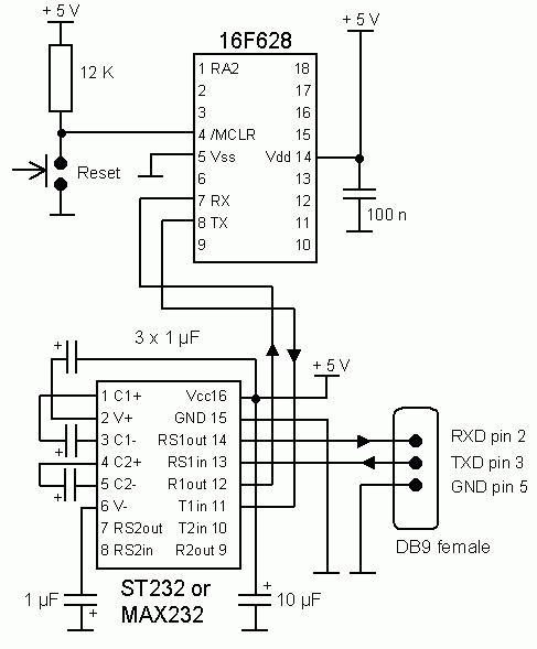

I am looking to build a device that interfaces with the serial port (rs232) to start with this will simply turn on/off LED's
i am using a 16F628.
I have built a visual basic program, and what this will do is send a 1 or a 0 and a pin number down the serial port.
What i want the pic to do is recieve this 1 or 0. Then set a pin on the pic to either a 1 or a 0 depending on what has been recieved.
the circuit i am using to interface the pic with the serial port is attached below.
i dont have any problems building the circuit or writing the VB program, the problem comes with the assembly. I simply dont know how to "read" the data into a variable and then read this variable to set the pin.
Could someone point me in the direction of a tutorial or please explain in detail what i would need to do.
