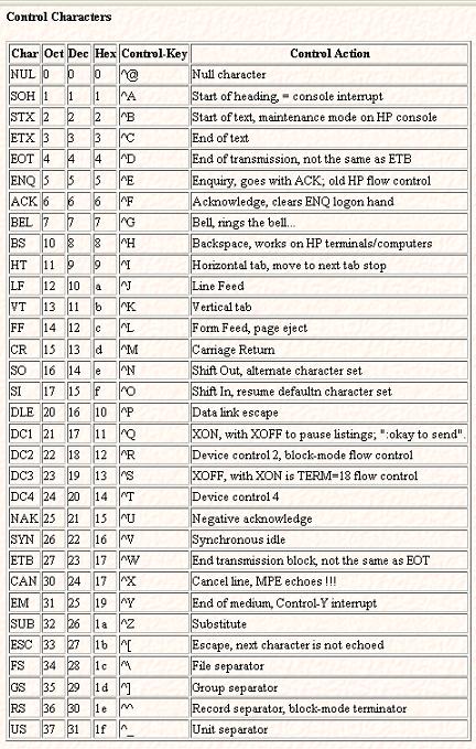

Thats what i would have written since it would allow you to simply send a Line Number then the ASCII...
atom the case 13 the 13 is a serial command for carriage return 27 is new line that's why he did it that way
only bad thing is not all serial software works the same sending data from the pc to the pic
It would if you define 0 as X command, 1 as XX command and so on
But the thing I have run into is that not all serial programs send commands the same like If you send line feed it should be
^j but some send #LF and some #10 and some maybe ^10
It's crazy no real standard
Line feed should test as 0x5E4A Or if byte 0x5E and next byte 0x4A then we have a line feed
Or 0b1011110 01001010
