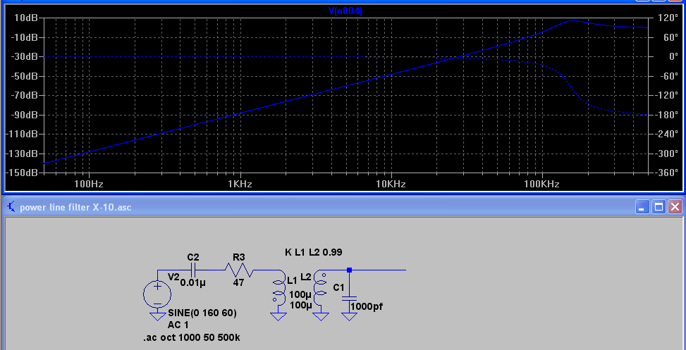

I have an AC transformer - 24VAC @ 60hz (fed from 120VAC mains) that feeds a common set of power buss rails in a control assembly.
On this 24VAC buss, we need to inject 315mhz RF from a 2400 baud transmitter (FSK/ASK) and the separate this 315 or 433 Mhz signal back off of the power buss further down the assembly in several locations.
What is the best way to:
1) couple the rf signal and inject it on the 60hz power buss? and
2) what is the best way to pull off just the 315 or 433 mhz signal, but not the 60hz?
I've considered using a high pass filter to just get the 300+ mhz freqs, and then a 60hz notch filter (will this pass the 315 mhz still???) in series to take off anything remaining... or a SAW as a bandpass filter -- but after a few attempts -- I'm not sure if I'm actually solving the problem -- or just throwing the RF hot enough where it's going thru the air instead of the power buss and working (intermittently) anyway.
Any suggestions on circuits? What I could google? Recommended ways to get these signals in and out of the 60hz buss?

On the left side of the schematic there are two 0.022uf high voltage capacitors. These pass very little 60hz and a large amount of high frequency.
T2 inductance and the 1000pF cap resonate at the carrier frequency. (band pass filter)
The transformer also isolates you from the power line. The primary to secondary breakdown voltage should be high.
10k and 1000pF and two diodes are for over voltage protection.
Search for "X-10 schematic" and "power line schematic"
Please excuse me still learning on this -- but if you were going to put this together -- where would you start in calculating wire wraps/ratio/gauge wire/core type for transformer and the selection of the values for X2 in the diagram (the inductors)?

Do you have a network analyzer. It will generate a scan from 50hz to 500mhz and you can see the filter's response.
Because you frequency is much higher than the schematic I posted you should make the capacitors smaller. 650V to 1,000V.
That transformer is for audio. Look for a "pulse" transformer.
I would start out with SPICE. You can sweep the filter and easy change parts.

I think you will have problems making an inductor to resonate with 1000 pf at 433 Mhz. It would need to be 0.135 nH (The reactance of a 1000 pf capacitor at 433 Mhz is 0.37 ohms. I do not think it is practical to transmit 433 Mhz over power lines. I have just looked up the frequency used by X-10 protocol to communicate over power lines. It is 120 Khz

I made a quick filter for X-10 frequencies. You can see there is a small amount of gain at 130khz. You can see 140db of attenuation at 60hz.
