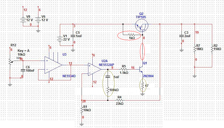

I'm trying to make a voltage regulator, and it work but under certain conditions it doesn't work as it have to.
I put my reference so i get 15V as output
At low current, i can get 15V output. (15mA)
At high current, i can only get 12V output (100mA)
I put my reference so i get 10V as output
I can get any current i want.
The IN voltage to be regulated is 17V, the opamp is powered with +-12V
I don't know where is the flaw in my "more than common" design
In the simulators (Microcap, multisim) it work ok, but in real-life it doesn't

With R2=10Ω across the output you will be drawing over 1 amp of current.

Try putting an inductor (100 to 300 uH) and Schottky diode (anode to ground) on the output before the sense feedback connection. That is standard practice for step-down switching regulators. See: Linear Technologies app. note 35 (there are several other app. notes as well). John
It's not a switching regulator, it's a linear regulator.
I'd be very surprised if it doesn't oscillate.
Q1 and Q2 are not configured as followers and will add lots of gain which is bound to give it a gain >1 with a 180° phase shift at some high frequency.
You need to place a compensation capacitor somewhere in the feedback loop. I'd start off with 10nF between node 28 and 19, then try larger and smaller values.
Its linear, not switching... the opamp has a negative feedback (control loop).
(And i use a capacitor in the feedback loop (in the 22K) but i took it off from the schematics for the sake of simplicity)
And i don't get the idea of Q1 and Q2 as followers, they are not followers, they are commanded by the opamp (with control the current that goes to Q1 and then, goes to Q2)

Have you looked at points 2, 8, 9, or 16 with a scope? What do you see?
John
I don't have an scope, i'm a south american student and here, the osc are very expensives.. but i can check on my faculty lab on tuesday.
I changed R6 to 270ohm.
All this i check with my multimeter (an UNI-T UT70A) with one of the probes to ground.
I change the Vin to 17,5 (another non-regulated voltage source)
Putting the Vref as 10V, i won't get 22V, and i get 15,6V (which seems to be the max i can get as output)
point8(p8) = 14.7
point2(p2) = 0,2
point9(p9) = 11,1V <-- opamp is saturated to 12V (V+)
point16(p16) = 0,9V

You have much more loop gain than you need, combined with multiple poles that are causing oscillation. I played with your circuit on LTspice and empirically came up with the modifications below. Simulation doesn't always correspond to the real world. Give it a try and let us know how it works.
EDIT: You should be able to get at least 20V out with a solid 22V unregulated source (if it has ripple, it must stay at least 2v above the desired output voltage). Keep in mind that your gain is 3.2, so the reference will need to be 6.25V for a 20V output.

You mention Vref. What voltage are you referring to?
EDIT: Do you have compensation on the NE5534? It is not stable below gain=3. You don't even need that op amp. The input impedance of the NE5532 is very high.

As everyone else has said, it's linear, UA2 is an opamp connected as a comparator - and like everyone else has said, it won't work because it's lacking in capacitors to keep it stable.
As Roff said, you don't need the first amplifier. I would use a reference IC to provide a stable voltage reference for the NE5532; otherwise, any change of the input voltage would be amplified at the output, resulting in poor regulation.
That said, I've always used an NPN device as the pass transistor for that topology.

First, i added the follower for the voltage reference(represented by the potentiometer) just to be sure i don't have a problem there.
Well, here is the new schmatics that doesn't work also in real life, i change some stuff from the feedback i got here.
I changed the opamp for an op07, i added more gain (9,1) and really nothing else.. it doesn't work either.
But the thing that keeps me looking strange is..
i put the voltage refence so i get 14V as output
1 - with no load, i get 14V
2 - i put some load, i get 13V
3 - i put more load, i get 12,4V
4 - i put even more load, i still get 12,4V
5 - Getting more than 700mA, i still get 12,4V
So, why could it be? The output voltage goes down with current but it stay at 12,4V no matter how much current i try to get it out... (obviouslythe correct voltage output should be 14V)
Its like the circuit get stable at that point? (the opamp input voltage are +-12V) also, at that point the opamp get saturated..

If you have loop compensation (the RC network that I drew), why don't you have it on your schematic?
this is a lower down schematics for this post, i will post the full schematics but for now, i think if i can't make this part work, the other dosn't matter.
The full circuit will be a digital controlled power supply with current control also.. and in the simulator everything works like a charm, but... this part, the voltage control is the most important part of the circuit.
and i put the RC network and the Cap between(28,19) but it doesn't change the actual behavior of the circuit.
