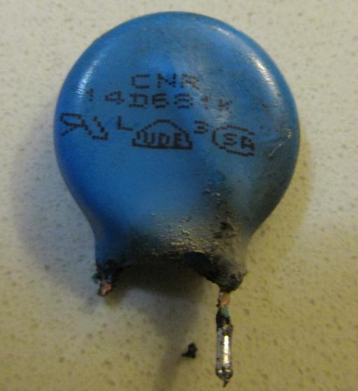

Dear chemelec, spec and pfofit,
again thanks for the big help,
the black varistor indeed was a housing box for the original varistor,
this is the original faulty varistor:
the original one is look same as the replacement.
i guess the is no polarity for this part , because i dont see any sign for a polarity (e.g. +/-)
i opened the black housing box,
took out the faulty varistor,
put a new one inside the black housing box,
solder the fixed one to the circuit,
put a new fuse,
and today im gonna go back, up my roof to put the circuit back in.
and prey that no more parts got faulty on this circuit board.
i will update,
thanks .
itai.

Hy itaishi,
WOW! that varistor got hit hard.
Varistors are symmetrical- they have no polarity and can be fitted any way around.
In view of the extreme varistor damage, it would be best to check the continuity of all connections between the mains plug and the board. It is likely that other wires/PCB traces will have been taken out too.
Lets hope that no other components have also been damaged.

just to clarify :
the 2nd varistor's leg was broken by me, when i tried open the black housing box (to get the faulty varistor out of the black housing box).
so the damage of the varistor is not looking so bad... (i think so)
what i didnt take a picture of, is the pcb board that indeed have damaged,
under the varistor place, there have been a little black steam/crater ,(this is how you called it - crater?).
it was a little bit hard to clean it.
final status:
the air condition work perfect for almost half an hour :happy:
(the symptom before the error was that the air condition was shutdown himself after 10 seconds and had a green light flashing fast)
spec, chemelec, pfofit,
well done everybody !!!
i really owe you big time !!!!
:D
Hy itaishi,
Well that is good news. The varistor obviously did its job and protected the rest of the components.
All the best
spec
