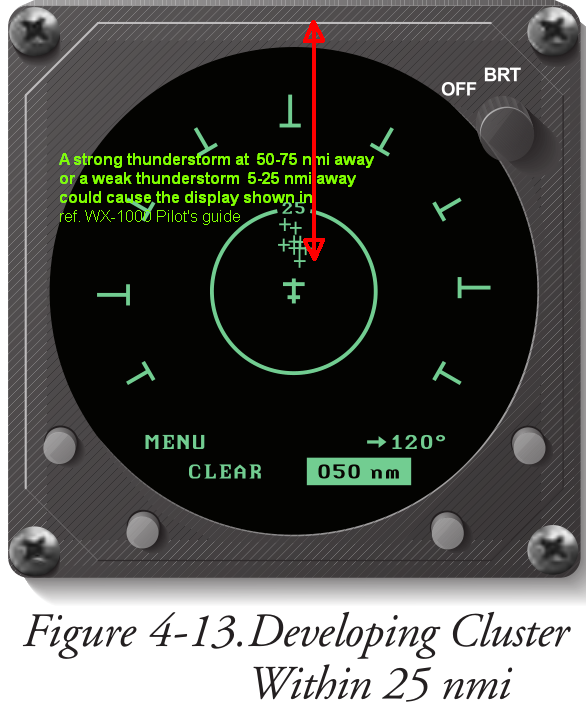

    @Post#2: I am sure you have heard of a piece of avionics called Stormscope. It is a lightning detector that can be used in lieu of or as an adjunct to radar. Its inventors found that turbulence was more related to lightning frequency than to rainfall intensity. It was cheaper than radar and more adaptable to single engine airplanes than radar was. It provided direction and ranging, but the manufacturer was pretty secretive about how it obtained ranging. Of course, triangulation will work, but it is not really practical for an individual pilot to do.
    Thanks for the added info on high voltage arc chemistry. I was not aware high-tension lines were even insulated.

    Not heard of Stormscope but from seeing how it works, it would use a bandwidth around 1MHz rather than up to 1GHz so the resolution is not enough for short distances.
    I understand how it works, and have to give the guy full marks for marketability, and huge profits.
    The radar data is rather misleading if one were to compare with a satellite representation. I would steer at least 25 miles away from it.
    Basically he uses amplitude of the impulse noise to determine distance and directional antennae sample and hold the levels while the software bins them. Location of (+) on the radar scope are irrelevant and just show the frequency of discharges per time interval, which could be a minute or more and thus if traveling at 5 miles per minute or 300MPH in a jet would be offset by at least 5 miles. He shows 7 directions in front which were stated as passive antenna with S&H. So basically it a glorified impulse counter with range and direct determined by signal strength. Effective for detecting lighting after it strikes.
    Single events are ignored unless close range.

    I assumed incorrectly that Stormscope was something you may have heard of and that its technology might have application to your proposed project. It has around for at least 30 years, and it is incorporated into some pretty sophisticated aircraft along with radar. Of course, pilots used the ADF indicator long before Stormscope to get a feeling for the direction of lightning strikes. I had radar in my last airplane, and it has limitations too.
