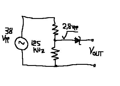

hello all,
i was doing some basic tests with a schottky diode, without succes, so finally i've decided to ask for some help, since i'm sure missing something important about the theory.
I have put up a circuitry like in the picture attahced
circuit-jpg.16375
I would try to rectify the reduced 125 Khz signal. Due to the 125 Khz frequency, i've decide to use a schottky diode (don't know if the choice is appropriate), so i was expecting to see in his cathode a only-positive pulsed half-wave. Instade i continue to see by oscilloscope a complete sinusoidal wave.
if any help,
many thanks, angelo

What kind of diode are you using? Diode capacitance can cause this. If you are using a high-current diode (high capacitance), then you need a low-value resistor as a load. You apparently are using an oscilloscope. The input resistance is much too high.
Yes, the input resistance of the scope is very high, like more than 1 Mohm. You need to load the right side of the diode with a resistor to get what you want. Resistor value should be much more than the values of those two on the left, but not nearly as high as 1 Mohm.
If your Schottky diode can survive 38V then it should have the attenuator as its load like this:

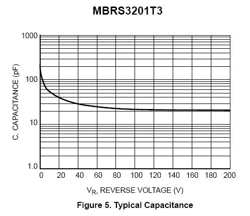

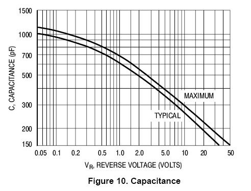

Schottkys are fast, yes? Silicon-metal diode, no minority carriers to sweep out? Or is my semiconductor physics bad?
Big Schottkys have big junctions, and therefore lots of capacitance.

Thanks all,
sorry for incomplete data, the diode i'm using now is 1N5819, but i eventually can buy another one i need in 5 minutes from my home.
Yesterday i've imagine something about it, looking some diagrams here and there, so i've try to load the right part with a 33K resistor, but i can't measure anything anymore at the cathode, 0 level always.

What are the values of your resistors, and why are you doing this?
values of my voltage divider are 10M and 2,2M. Actually i'm just wandering how i can see the positive-only signal i was expecting, with negative part cutted by the diode, and then if possible to have a DC from this signal, using a capacitor.
angelo
A total of 12.2M is not a load. Try it with 10k in series with 2.2k.
