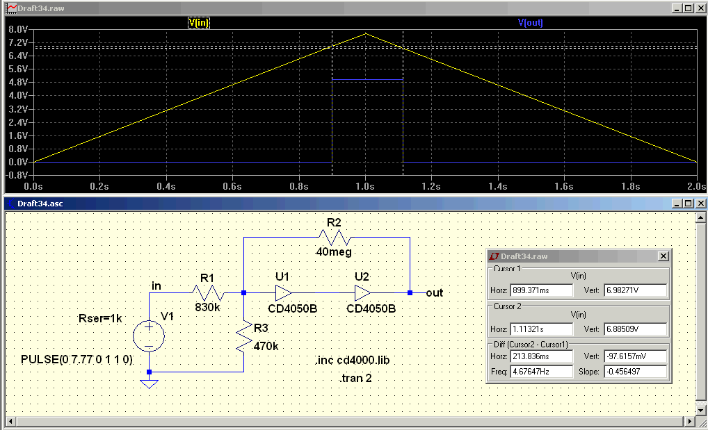

Here's a possible hardware solution. Not sure how stable it would be, though.
I modelled this over a -20C to +40C temperature range, with no noticeable shift in the trigger thresholds. Don't know how good the CMOS models are for temp dependence.
CCT and JimB. Unfortunately, the ADC is heavily committed to another use, so I would prefer not to have switch the processor's analog multiplexor back and forth to two different analog channels...
Alec. I like the CMOS inverters. With the CMOS chip powered from 5V, that makes a clean Arduino input swing with controllable hysteresis.
I've just realised I showed two non-inverting buffers (out of habit I'm usually twiddling with inverters). No matter ..... either will do :). The 40Meg feedback might be a problem. All resistor values could be scaled down if your radio can handle more than a few uA load.

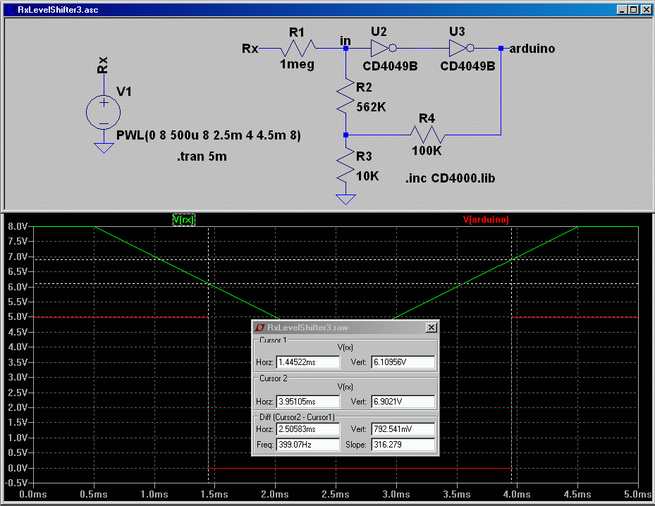

Here is my version of Alec's suggestion. It uses more reasonable resistor values, and has a high input impedance.
Off to breadboard it...
Much improved feedback arrangement, but I'm seeing 800mV hysteresis with those values. I thought you were aiming for 100mV? If R2=550k and R4=1meg you'd be on target.
Actually, after working with the receiver and an RF signal generator where I can make the signal level very close to the squelch threshold, I saw that I needed more hysteresis.

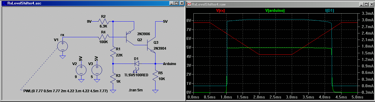

Thanks for that... Here is what I did with it. I played around with it to make the Arduino pin swing 0 to 5V, added an LED as a level-shifter and visual indicator, and tweaked the trip points.
Nice improvising there. Trip points will change a bit over temperature and resistors values will have to be tweaked for the beta of the transistors actually used, but hey, it's simple.
