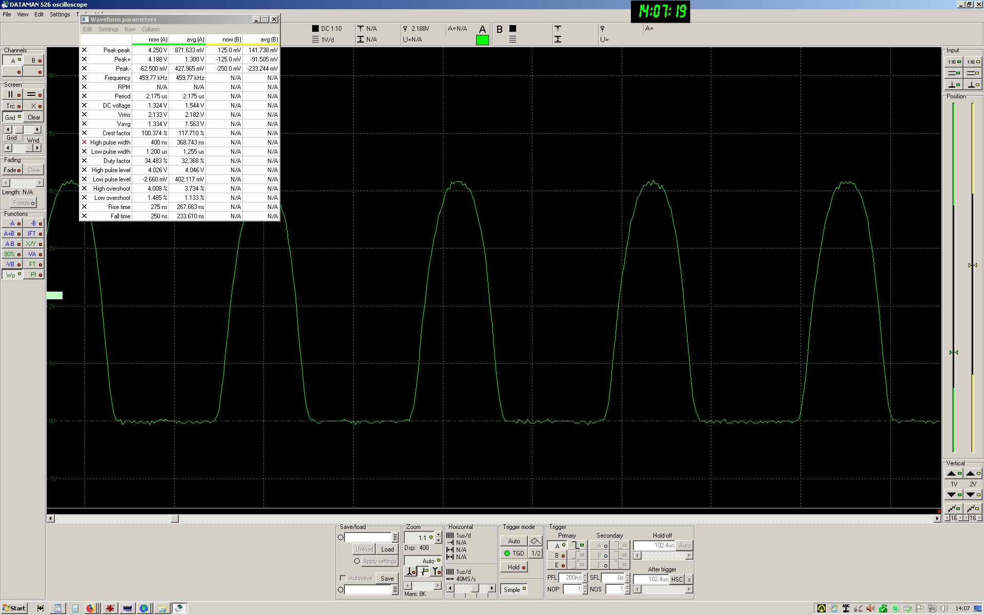

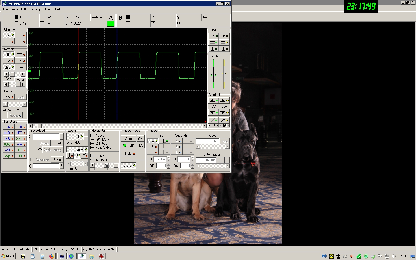

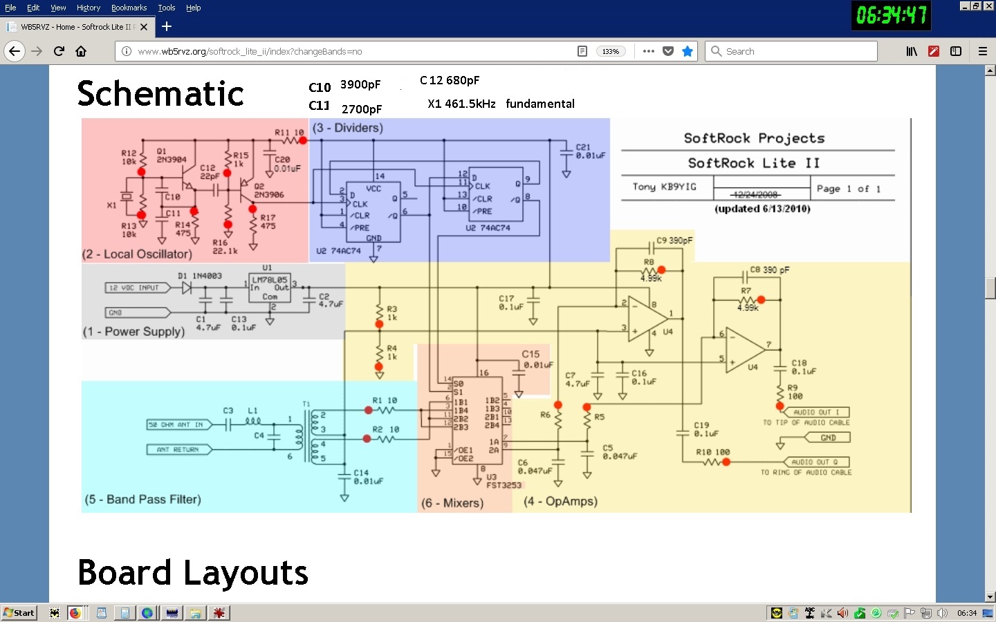

I have a Colpitts crystal controlled oscillator on about 460kHz. The slow rising edge was not triggering a divider reliably so I added a Schmitt trigger IC, capacitively coupled to the buffer amp collector, of Q2 and biased 50 / 50 across the 5V and ground rails with two 10k 1% tolerance resistors.Whilst the resultant waveform is square and clean it drops below zero. Why is this, it also does it without the bias resistors, and DC coupled, and is it of concern please. I am bread board testing it without the divider. The files are with the Schmitt trigger, at its output pin,no divider. The schematic, without Schmitt, and the output at the collector (despite the wrong file naming....) of Q2 without the Schmittor divider. Probe is at X10. The interconnecting leads are a bit long and just ordinary wires.

If your Schmitt trigger chip is powered from +5V and GND, I don't see how its output can possibly be going below GND. The only possible cause for what you're seeing, IMO, would be a X10 scope probe that isn't properly adjusted. I just don't know what else it could be.

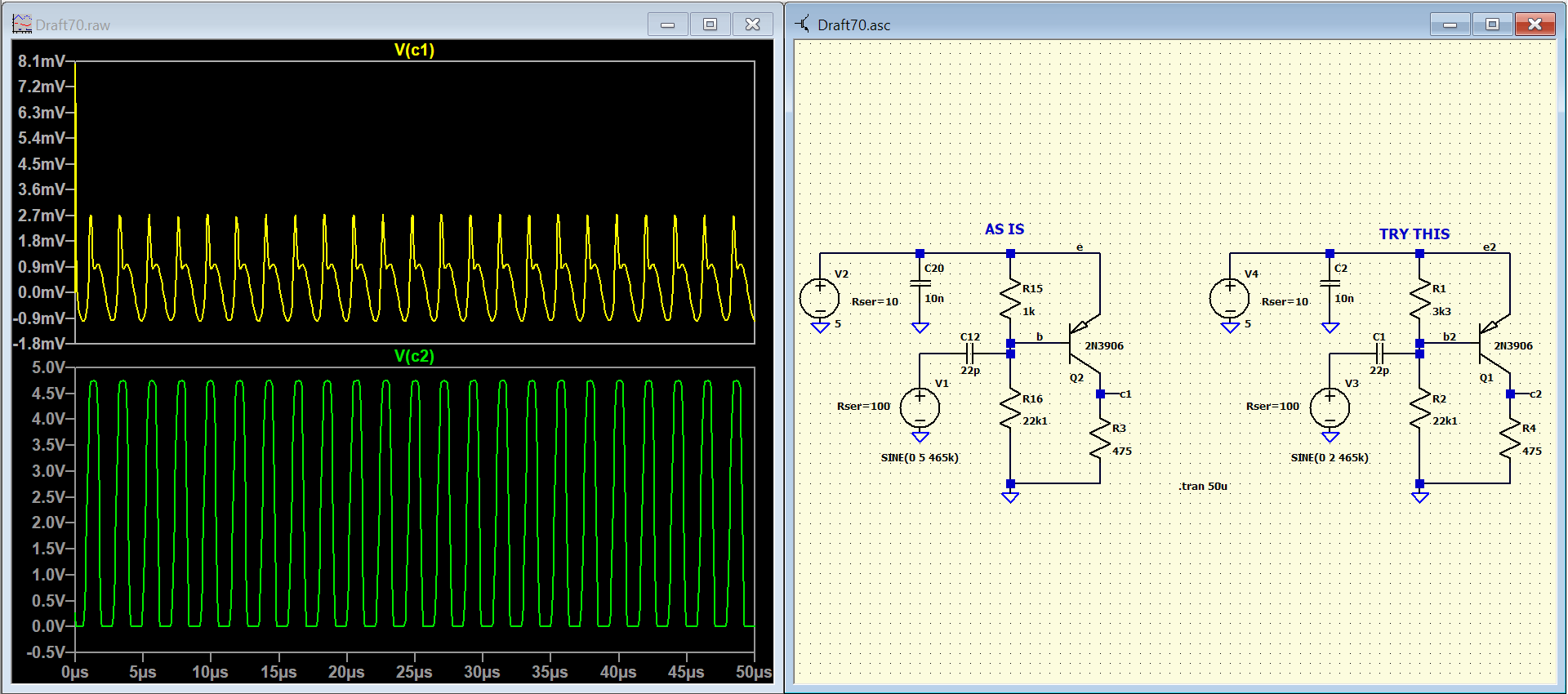

I doubt you need a Schmitt trigger. I think the problem lies in the biassing of Q2. With R15 only 1K, Q2 is not conducting, and even if C12 is driven with a full 5V amplitude signal the Q2 collector voltage does not reach the logic high threshold reliably. Try increasing R15 to 3k3 or even 3k9. LTspice indicates that should do the trick.
The issue is I have modded the thing to run on LF so the rising edge is slow and not very sharp, but for sure I will try fiddling with the bias, perhaps with a pot initially. I see what is meant by impossible to go below ground with the single supply, maybe it's a grounding issue as the lead lengths are long as the Schmitt is on a separate bread board for trialling. Many thanks :) Very good of you to model it!!
Are you sure? To me it looks like a normal waveform on a scope with either the zero (DC balance) adjustment or the vertical position a bit off.

Yes, the numeric display shows 500mV negative. It was poor grounding, I tidied things up a bit and it's fine now, thanks for all the info and help.
