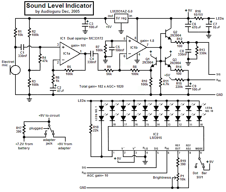

All my schematics are made with Microsoft Paint program.
Straight lines are made by holding the SHIFT key down. Most parts are copied and pasted from other schematics of datasheets.
Here is one schematic made with Microsoft Paint program:

That is one sweet looking schematic. But...for a beginner to start from scratch would be a real pain. Do you have a library of components you'd care to share with them and us?
