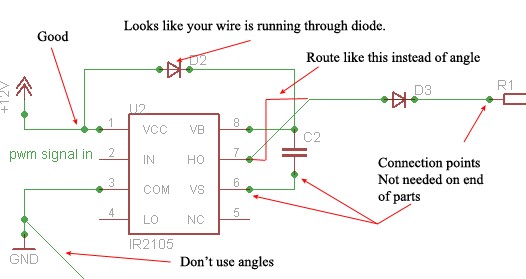

here is my first schematic using it:
Link Here
Tnx for the replys.
Looks like your learning, but you need to know when to terminate a wire. There should be connection dots where a wire terminates into another wire, also you have wires running through your components such as your diodes. But do not despair, these things can be corrected.
Did I get carried away with dots? or is this about right?
I made some suggestions in the image below. See pic.

Thanks!
I will kill the angles. Won't use dots on all the parts :)
As for the diode, that was just one of the styles in eagle, the line through it was part of their image, guess it looks misleading. I will try to use a different style next time. Maybe something more standard. (I built it hurriedly so I just grabbed the first ones I saw hehe)
tnx again

The dots indicate junctions. They are present where two wires meet but not where a wire meets a pin (circle). They are automatic as suggested by Mikebits.
You can also place a junction most anywhere by selecting it from the tool bar. Infrequently used.
You should not have a junction where a single wire meets a pin. Use the zoom tool to find the extra wire and delete it. If you have to delete the wanted wire too and redraw it.
If you are unsure if a wire is connected to a pin you can grab it and try to move it. If the wire does not move away from the pin it is connected.
When you are learning keep the wires vertical or horizontal. Do not use the right mouse button or the icons on the tool bar to draw angles or curves.
