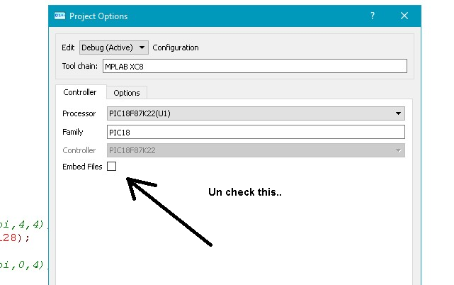

how can i save .c and .h files in proteus project folder automatically? currently(by default) the files are save in temporary folder in windows.
thanks
There is a check box in the properties to NOT embed source code..
