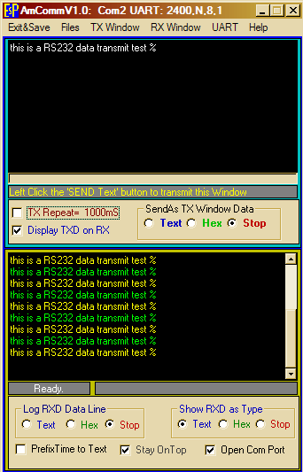

Sample of RS232 i/o. it works at full speed of 2400baud OK, no missing data.
Yellow is data from PC to PIC , the green data is received data back at PC.
