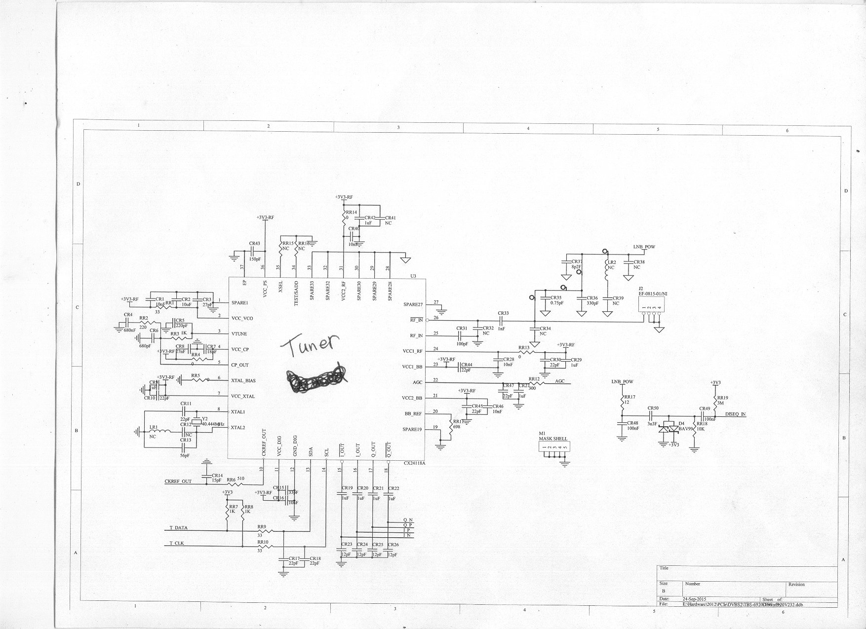

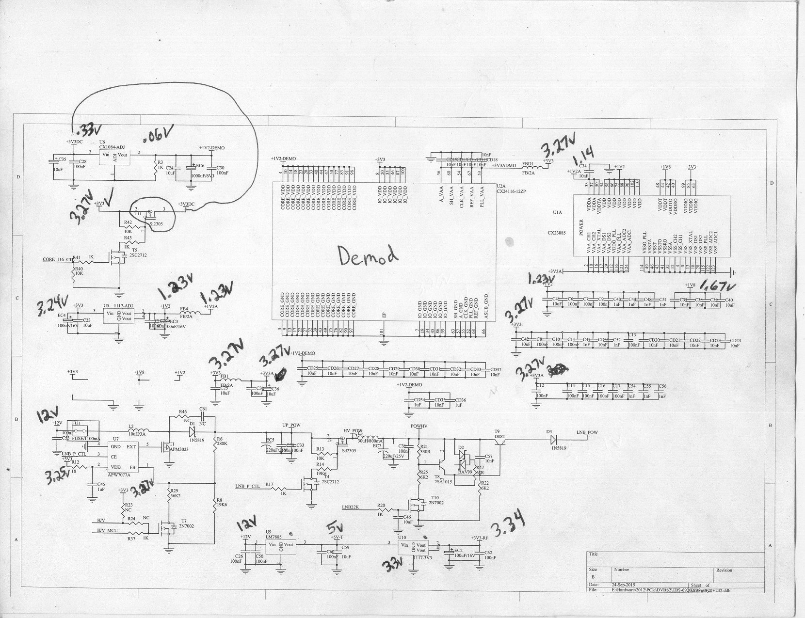

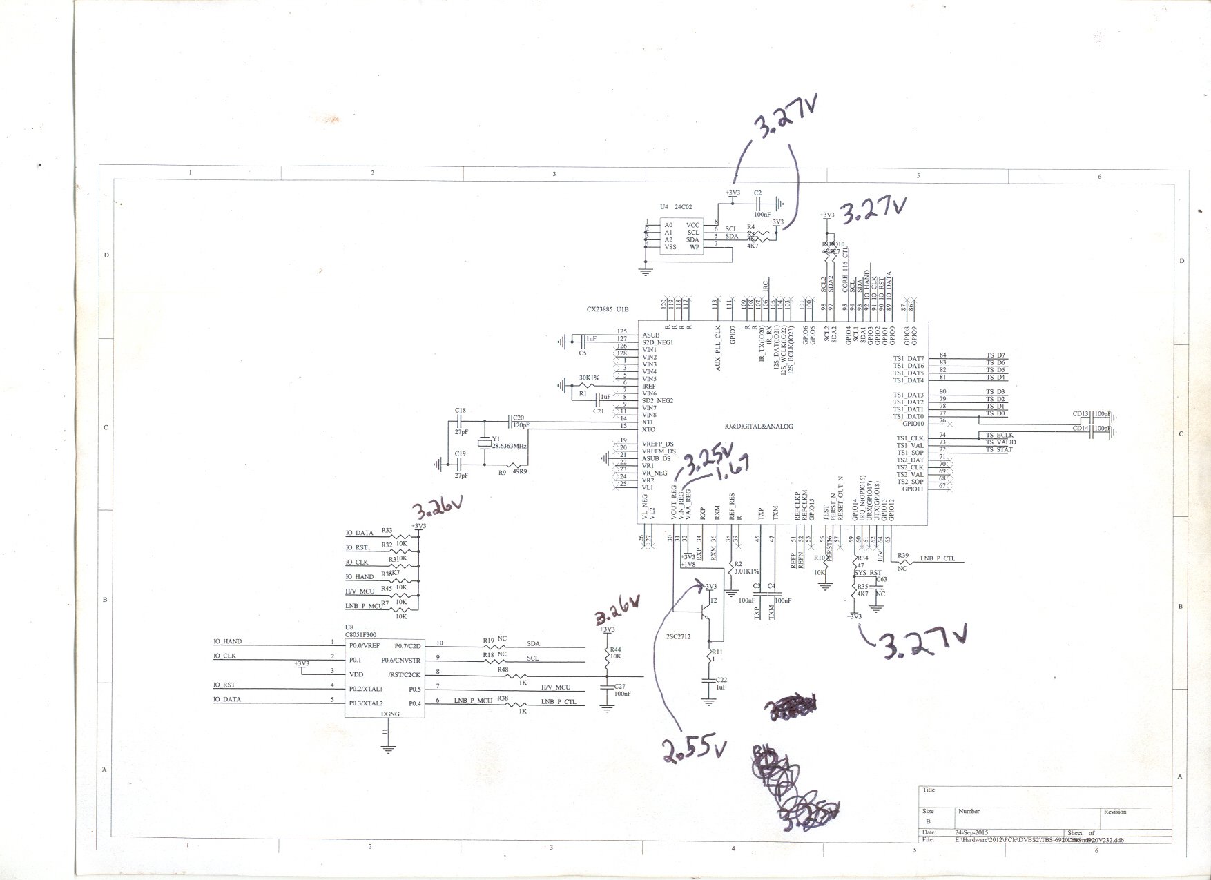

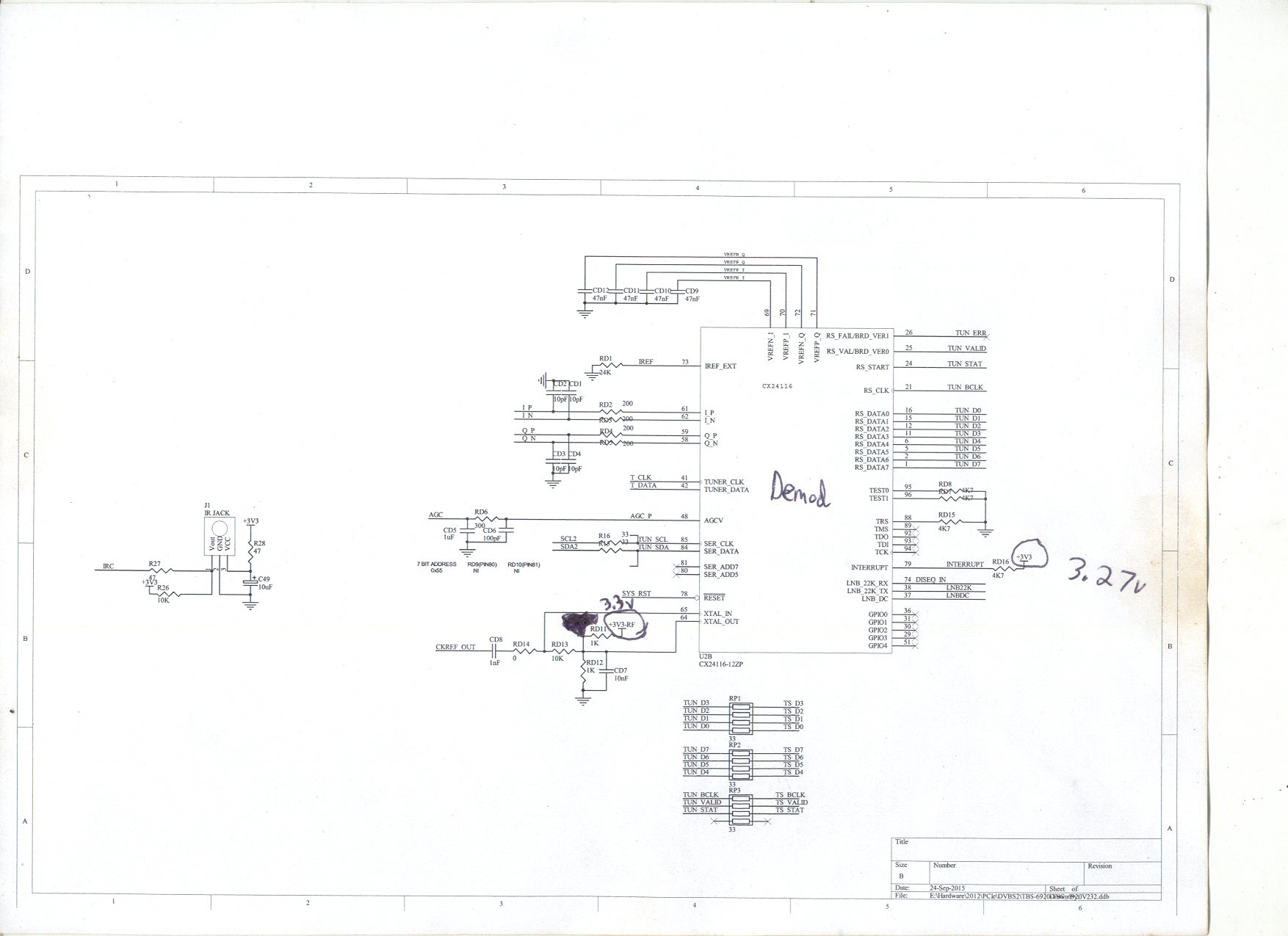

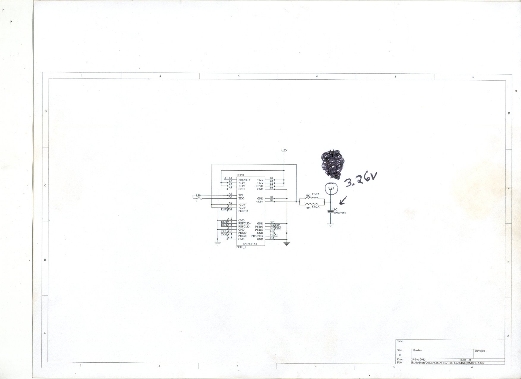

My tuner card works intermittently. The voltage on component T2( 2SC2712 ) is 2.55v instead of 3.3v. Is component T2 faulty?

T11 looks open. (broken or not turned on???)
Is T5 turned on? T5 gate voltage & T5 drain voltage?
