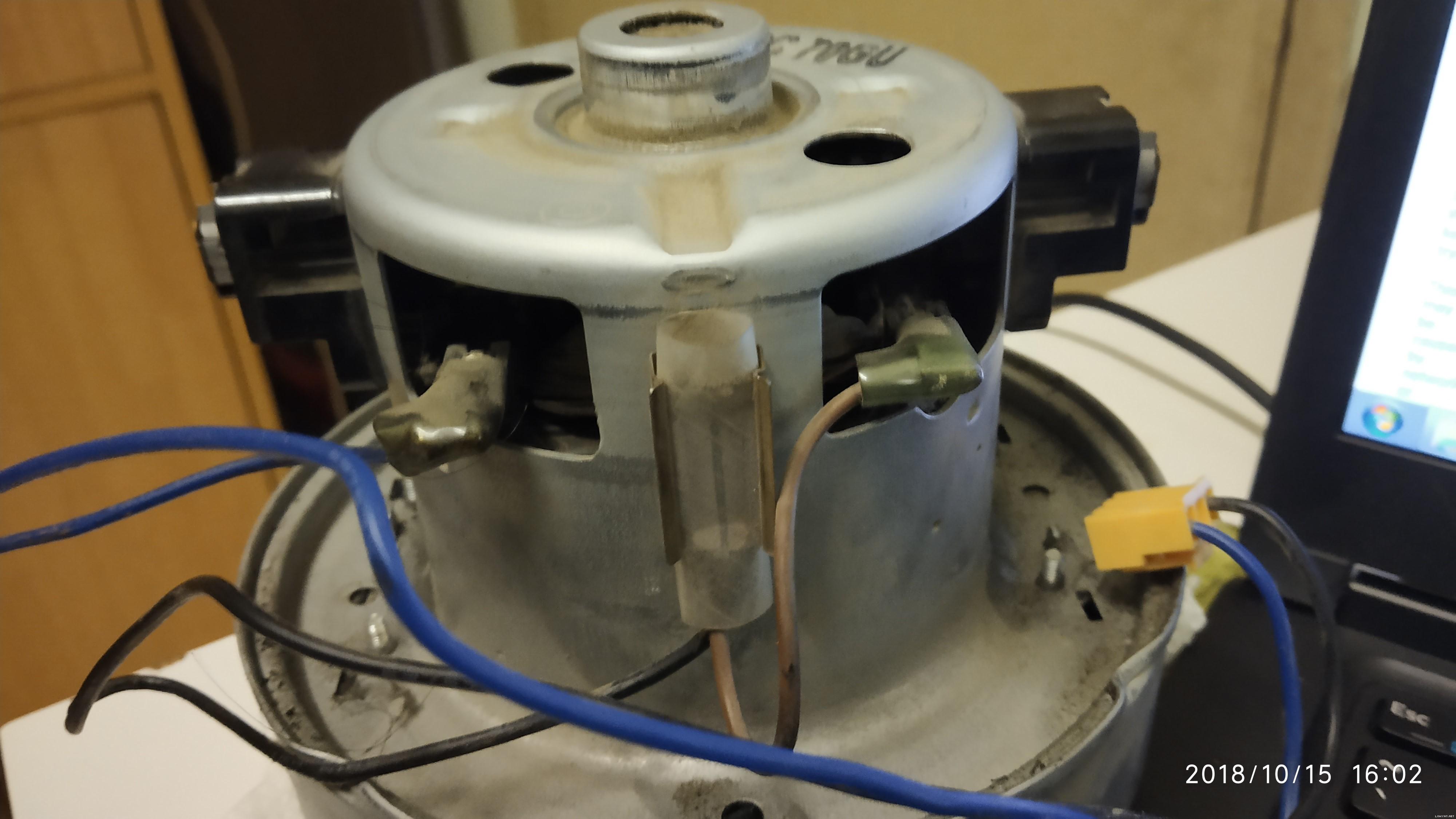

Yes, it works after cooling down.I would suspect a thermal cutout in the motor assembly, IF it restarts after cooling down.
Was the replacement motor designed as a replacement of the original motor?
1. thermal cutout faulty
2.thermal cutout not rated as original
3.insufficient airflow for cooling
4.blocked intake
5.improper reassembly (I have put the impeller on backwards before) air must blow through the motor.
last option (Not recommended) is to locate and bypass thermal fuse,, highly unlikely to have it overheat and not be noticed by operator.
I watched video you posted.Normally wound into the field windings of motor,sometimes visable on close inspection and sometimes buried under a lot of tape.
see the following

Motor is brand new.Have you checked that there are no filters or dust collection bags that clogged up with dirt which would reduce the air flow. With less air flow the motor will get hotter.
