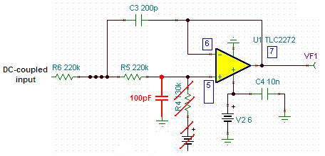

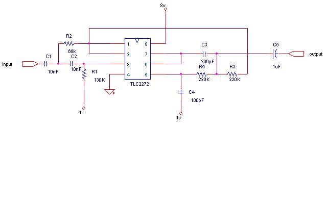

Hye all, here are my shcematic.Both of them doesnt work properly on the breadboard.I didnt see anything wrong with both of it.I conduct the experiment with audio generator as a input signal.The amplitude is set at 10mV.The first test is on the sallen key filter and 2nd is on the treble boost.Both of the circuit were test separately.
I put in a audio signal from audio generator and see the output on the scope.I started to increase the frequency and suppose the sallen key filter using TLC2272 will alter the signal above 3kHz.But the signal still appear at the output even i increase until 10kHz.
Same goes with my treble boost filter.It suppose increase the gain at the break frequency 10kHZ as i increase the gain from 100Hz but nothing happen as i observe the output at the scope.
At the first sight,there is nothing wrong with my circuit design.Theoretically,it will work as plan.May anyone comments on my circuit?

10mv isn't much of an input signal - the maximum offset voltage on that TL071 in the treble boost circuit is almost that high to begin with, and the Sallen-Key doesn't really amplify. Give it a bigger input, couple of volts peak-to-peak, and see how they respond.
Your circuit is connected wrong??
Your first circuit (sallen key) has the input connected to output??

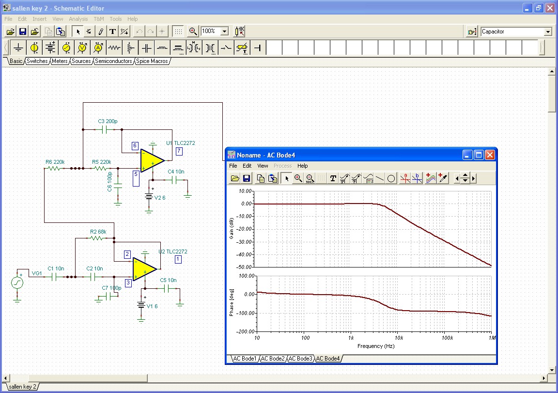

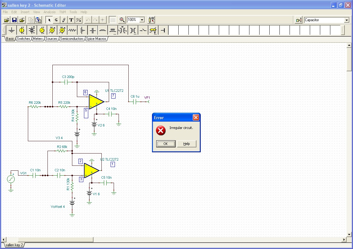

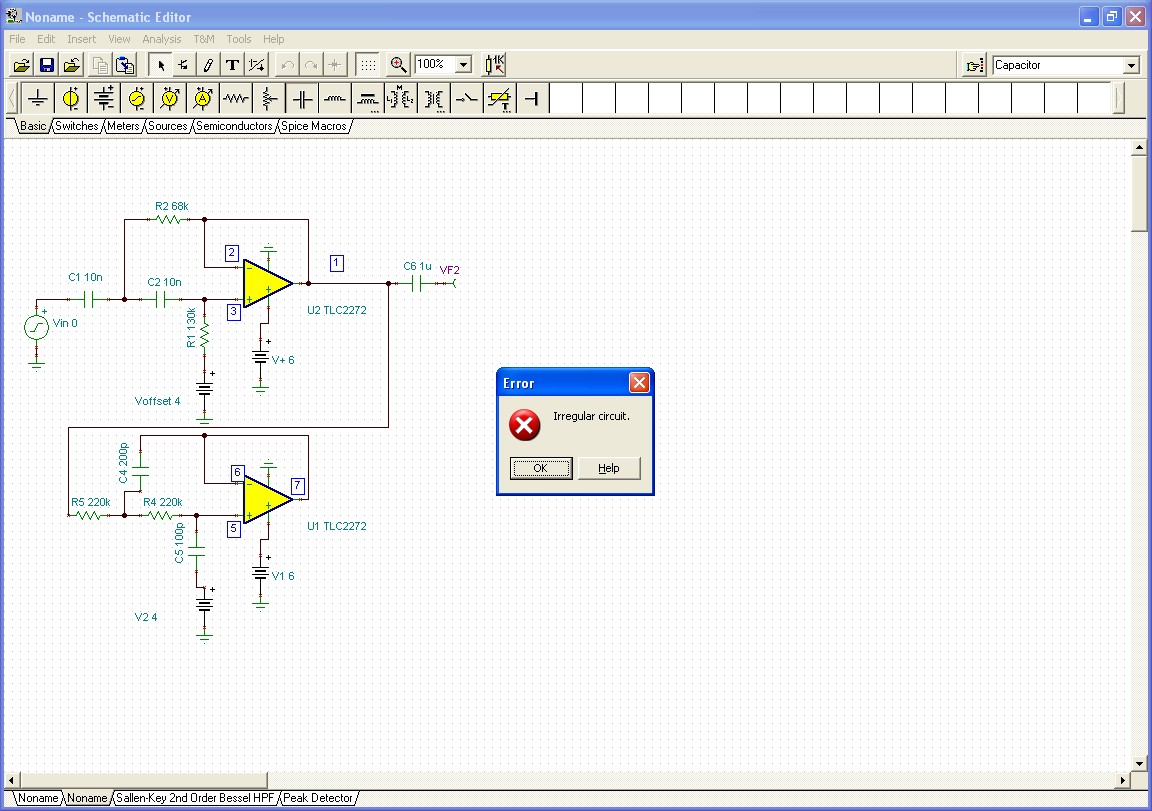

hope this is your circuit
yep it dosn't work
remove c5
kept comming up illregular circuit with c5 in circuit

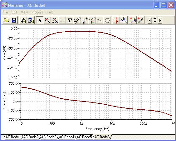

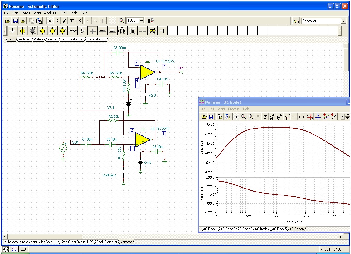

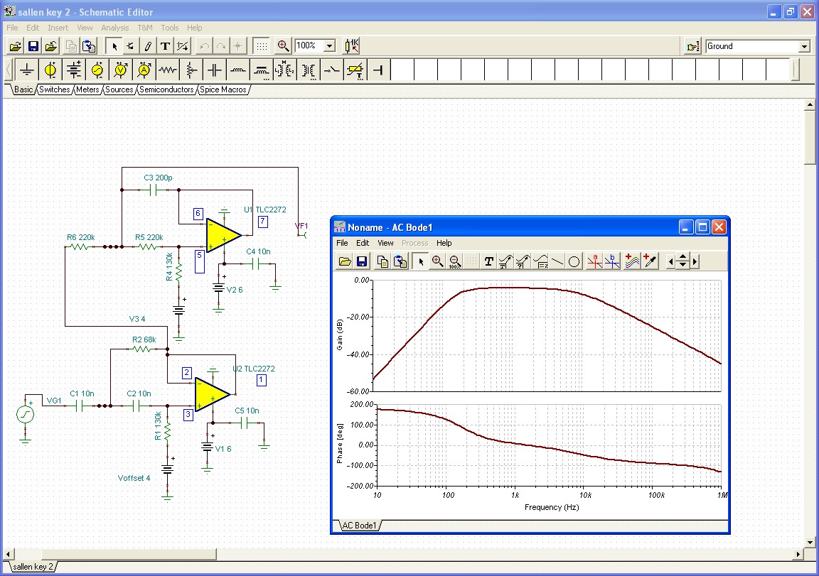

heres your circuit with out c5
removed c5 and circuit works kinda
needs tweeking for a sharper response??

full screen shot
oups only got partial shot

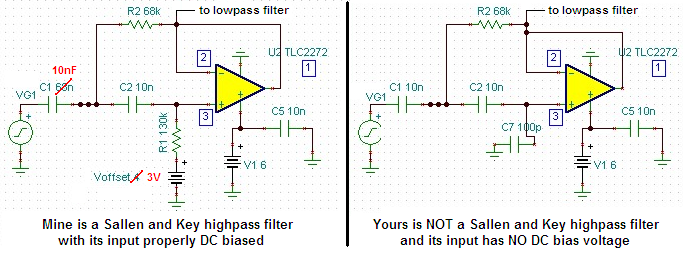

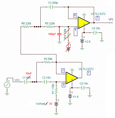

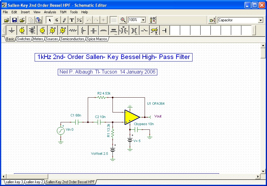

I think you should review the design of Sallen and Key filters. You messed them up.
Can you turn off the dots in your schematic drawing software?
10mv isn't much of an input signal - the maximum offset voltage on that TL071 in the treble boost circuit is almost that high to begin... Give it a bigger input, couple of volts peak-to-peak, and see how they respond.
Im already increase it to 1V p-p.Still the same output.It not increase the gain at break frequency.I leave the offset floating.Do i need to ground it?If im ground it,it will bypass the 1080Ω right?
I set the sallen key in unity gain.

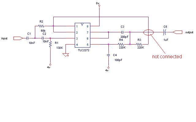

Hai Mr.DEB,thanks for trying to simulate it for me.:)
I think you had misunderstanding on my circuit.Actually i didnt connect pin 2 with pin 7.It directly go to pin 5 as you can see clearly in my early post.:)
Im sorry for any inconvenience.

I rewired and still dosn't work w/ cap
I rewired as per schematic with and without C5.
Dosn't work with C5

hi Mr Deb,
you have copied the messed-up lowpass filter.
Hai Mr.Deb, the C5 actually connect to the pin 7 as a coupling capacitor and not connected pin 5 as you draw.Im sorry again for any misunderstanding at my previous schematic.

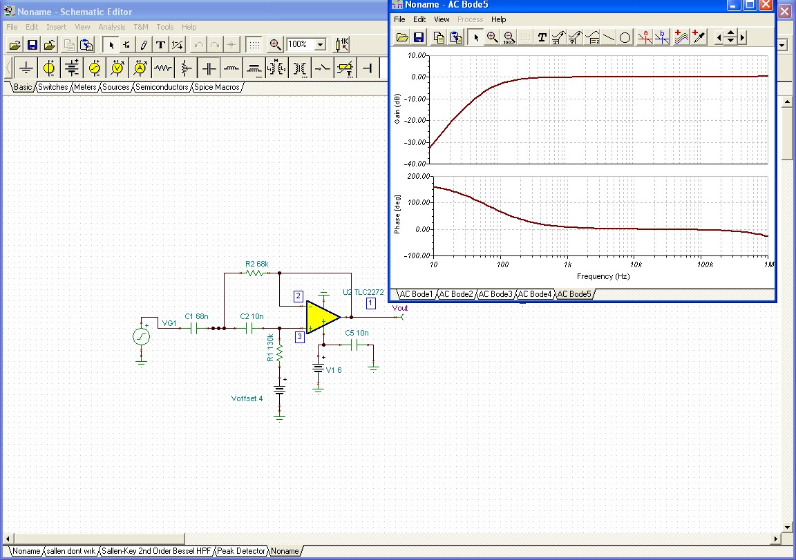

As my early post,why does my treble boost filter doesnt work properly?At low frequency,it will give gain about 2 and will increase at 200 gain at break frequency,10kHz.

You can float the offsets, that's not the problem. When you increased the input to 1Vp-p, did the output increase? Are the outputs of the amps at a +4Vdc offset?

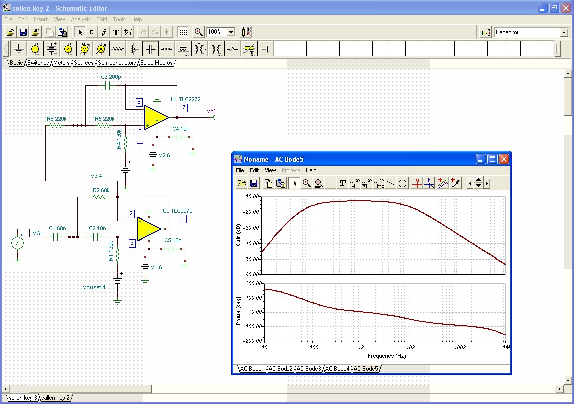

with and without offset battery
circuit with the offset battery then as per audiguru with out the battery
not real sure which is better for desired results

Mr DEB,
Please learn about how opamps and Sallen and Key filters work and are made.
Deb, you never leave either of the inputs on a regular opamp just hooked to caps like that. They will float all around and the output can go anywhere.
All I did was draw out the orginal circuit posted
on this thread.
not recomending any particular form of connections.
I did find that the orginal post had a cap on the output whitch I found using TINA that its an irreguar circuit.

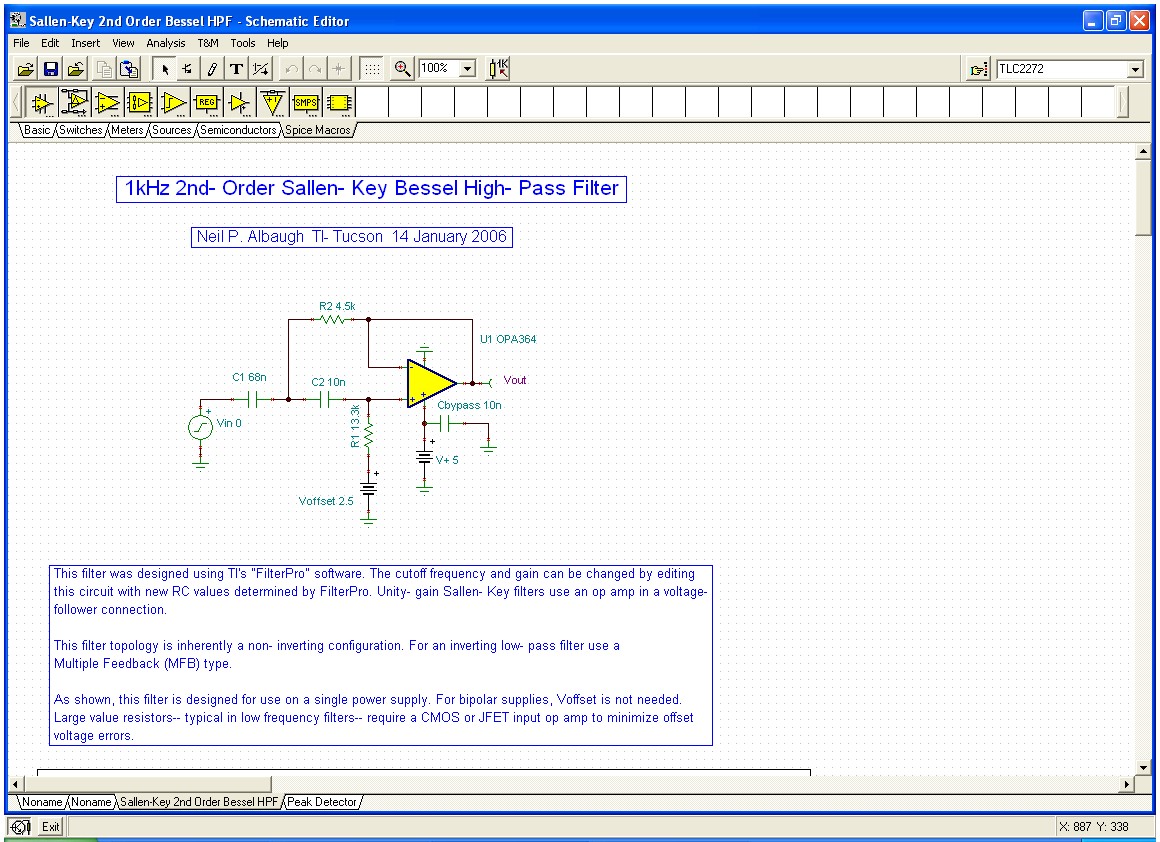

What I don't understand is why the battery in a sallen key but audioguru says to take it out?
Advantages of Saleen key vers ??
