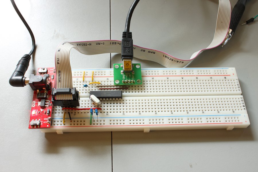

Since I have a 1814k50, can I convert it to operate as an mcp2200?
Any advice on the procedure to do that?

As be80be said, you can probably turn an 18F14K50 into an MCP2200 by flashing it with the firmware he linked to. I haven't done it, but it shouldn't be too difficult.
Or just buy an MCP2200.
After installing the Microchip Application Libraries and help files, and spending some time reading, I'm still pretty lost on how to do it. What you need is there, but it's not totally obvious to me what to do.
Looks like "USB Device -CDC - Serial Emulator" is the directory you want. Maybe I'll find time to test it one of these days. Microchip uses the phrase "Low Pin Count USB Development Kit" to refer to the 18F14K50, as that board has the 18F14K50 on it.
This stuff was written for Microchip's demo boards. You may possibly have to do some code mods to make it do what you want.
I decided to do it right away. I have the USB stack and CDC serial emulator demo code installed in the 18F14K50 and the driver installed on the PC. When I connect the USB cable the 18F14K50 connects (makes the happy USB sound ) and is properly assigned to COM5. But I don't think "CDC Serial Emulator" is the piece of code I want for what I'm trying to do. Must read more...
... But I don't think "CDC Serial Emulator" is the piece of code I want for what I'm trying to do. Must read more...
OK, CDC Serial Emulator receives over the USB cable and spits whatever it receives back out the USART pins (how a USB-UART converter does). Not what I had in mind for a first time demo.
CDC Basic Demo is better as a first demo test. It receives any ASCII character typed in the PC terminal and echos back that character + 1. For example, type A - the PIC echoes back B.
I have installed this demo and it works perfect. Now I have to dig into Microchip's ultra-heavily commented and confusing code and modify it to suit me. Should be pretty simple to convert it to a plain old USB-to-UART bridge. I can for sure do a TON of decluttering, since I only want to compile it for one chip instead of ten different chips. If you're not up to speed with C then you would definitely want to just buy an MCP2200 or CP2102 or whatever. This isn't the kind of source code you want to start out with.

Well futz, Actually I am looking for a USB to serial emulator.
So you're saying I can program the 18F14k50 with a hex file that you can graciously share and I'll be able to run PC USB to PIC UART HW comms via the 18f14K50?
It has become an MCP2200?
If that's so.. you have solved a large challenge I had w/o me having to order more HW.

I have an LPC pickit2 board mentioned in that thread...can u share a schematic of how to power the 18f14k50 while programming?
What is an "LPC pickit2 board"?
When I use my PICkit 2 (or PICkit 3) to program the 18F14K50 I simply set the PICkit 2 to supply 3.3V to the target. You make that change in MPLAB/Programmer/Settings.
If I'm running the 18F14K50 off a 5V supply I have to switch that supply off and reconnect (in MPLAB's Programmer menu) the PICkit 2 so it supplies the target with 3.3V for programming. Then switch the 5V back on to run.
If the circuit takes too much power for the PICkit 2 to supply 3.3V then I have to have an external 3.3V target supply that I can switch to (this won't be a problem with just the chip). I usually use a SparkFun PRT-09319 (there's one in the photo above). It can supply both 5V and 3.3V, selected with a switch. It can even be hacked to supply 3.3V on one side of the breadboard and 5V on the other.
The 18f14k50 is 5 volts if your not using the USB And to be safe I would only use 3.3 with it
This makes a com port

That code echo's what you type I also have USB to serial that works just like a com port the Zip is the whole compiler
OK, I've tested. Microchip's pre-compiled hex file, "USB Device - CDC - Serial Emulator - C18 - Low Pin Count USB Development Kit.hex" does turn the 18F14K50 into a USB-UART converter. Works perfect.
Or you could use be80be's code.
Either way, don't forget the VUSB capacitor. You need a 470nF cap between pin 17 and ground (I've successfully used a 1.0uF - close enough).
It's the easiest way I have found to use CDC and here the whole ball of wax
Ha! I haven't tinkered with JAL in many many years (back when Wouter still "owned" it). Maybe I'll give it a test again one of these days.
It as good as swordfish it has 18f chips support and lots of cool stuff like fat file sys for hard-drives SD and USB
i'll give it a go t'morrow, thx guyz!!!
That VUSB cap....goes on pin 17 of the 14F18k50? Do i use the microchip mcp schematic for the converter?
Ya, grab the MCP2200 Demo Board User Guide and look at the schematic in there. You can greatly simplify their schematic though. All you need is the 12MHz crystal and loading caps, the VUSB cap, a 0.1uF decoupling cap on power pins and maybe a MCLR pullup resistor. Look at the pics I posted - it's really simple.
The MCP2200 and this pseudo-MCP2200 are a bit more finicky than the CP2101/2 or the Prolific chip in the CA-42. Sometimes (always?) you have to start your terminal AFTER plugging in the USB to the 18F14K50. I haven't kept notes on its behaviour during various power cycling of different parts here, but there are situations when it just won't go until you shut it all down and start it all back up in the right order. I think the other chips are much less trouble - in particular, I really like the CP2102.
