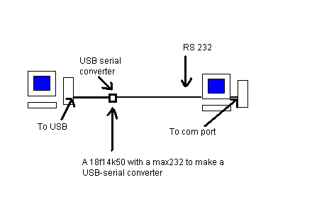

Since I have a 1814k50, can I convert it to operate as an mcp2200?
Any advice on the procedure to do that?

Well futz, Actually I am looking for a USB to serial emulator.
So you're saying I can program the 18F14k50 with a hex file that you can graciously share :) and I'll be able to run PC USB to PIC UART HW comms via the 18f14K50?
It has become an MCP2200?
If that's so.. you have solved a large challenge I had w/o me having to order more HW.

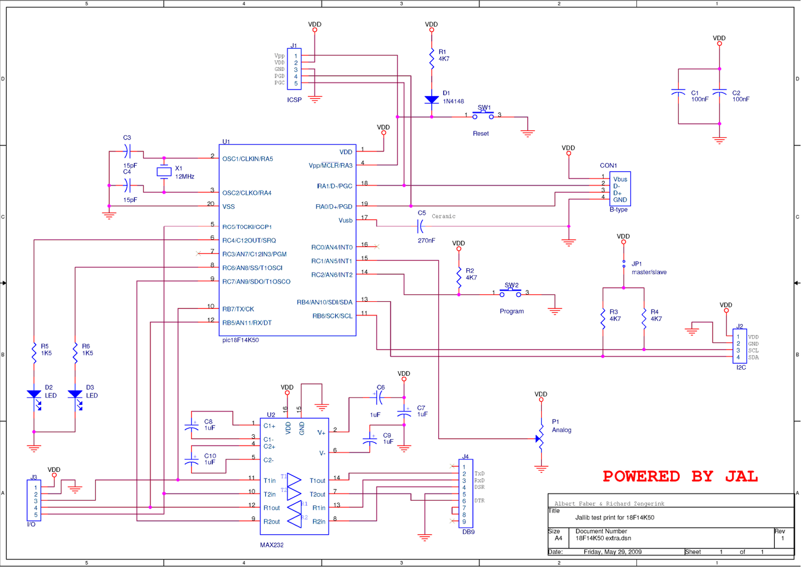

The 18f14k50 is 5 volts if your not using the USB And to be safe I would only use 3.3 with it
This makes a com port

;@jallib section chipdef
-- chip setup
include 18f14k50
-- This file is the setup for my homebrew, 18f14k50 board
-- Currently it is a bare board, with just a PIC and a couple of headers
-- A 12 MHz external crystal and 15pf caps connected to OSC1/2
-- pin 17 (Vusb) with a 220 nF capacitor to the ground
-- The connection between PC and the 18F14k50
-- +5v to power the board (don't forget 100nf decoupling cap
-- data- wire to pin 18 (D-)
-- data+ wire to pin 19 (D+)
-- ground wire to the Vss of the PIC
-- even though the external crystal is 12 MHz, the configuration is such that
-- the CPU clock is derived from the 96 Mhz PLL clock (div2), therefore set
-- target frequency to 48 MHz

It's the easiest way I have found to use CDC and here the whole ball of wax

Either way, don't forget the VUSB capacitor. You need a 470nF cap between pin 17 and ground (I've successfully used a 1.0uF - close enough).
