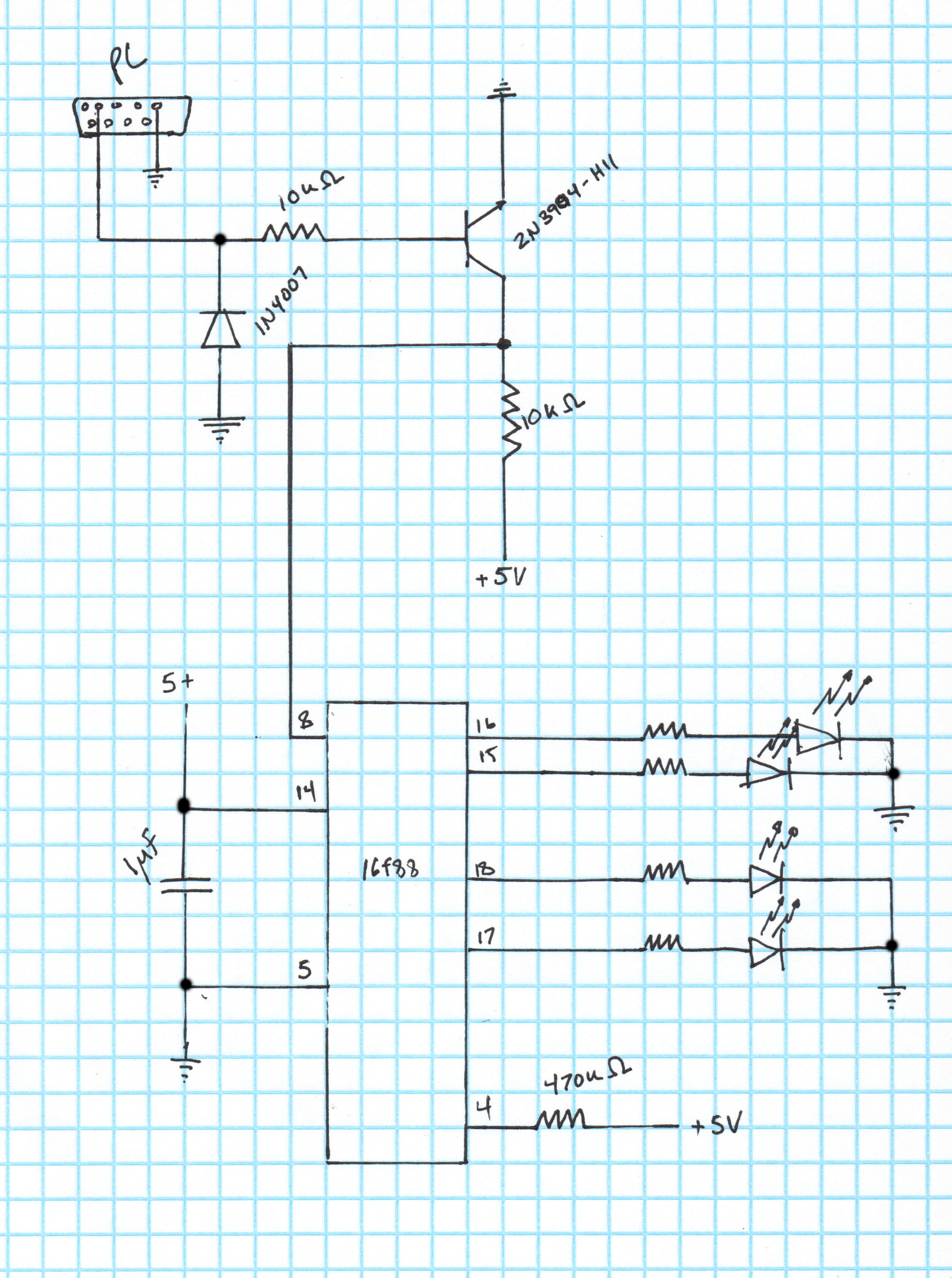

I've been trying to connect my PC to a pic 16f88, and have it flip some LED's to indicate that a byte was recieved. I am without a MAX232 mostly for money issues(I know they are only a dollar fifty), but also because I feel the more descrete components I use the more I'll understand whats going on.
I've built a voltage shifter and inverter to match the required 0-5V voltage level and the active low, as is required in the data sheet. I had a cicruit that I designed origionally, but I found a more simple design online and used it.

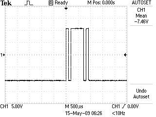

I have the Pic sending the character 'A' so I could hook it up to the OSCOPE for comparison. When I hook the TX to the RX the led's flip back and forth, telling me that the program is working. I wrote it using MPLAB IDE C(code bellow).
I have an OSCOP image of the raw serial output, which is -12 to +12(from a digital), and an image comparing the output from the chip to the output from the interface circuit(reading taken from the collector on the transistor without the pic attached time is 50uS and Volt is set to '5'). As far as I can see the timing and the voltage levels are the same.
I dont understand why the pic responds to itself, but wont respond to the PC..... HELP!!!
Thanks :)

Bit overly complicated - a simple series resistor is all you need (check out the BASIC STAMP circuit), and use a software UART instead of the hardware one (because you can easily invert it in the software). The RS232 routines in my tutorials will easily do it.
Nice work! I love the drawing.. done by hand? Looks clean and neat... i cant even use a ruler to make a straight line ... :D good job... dont take Nigels suggestion the wrong way hes just trying to make sure you dont go crazy doing something that can be done a little simpler... But i like it nonetheless
Thanks, Yes I did it by hand :). 3v0 Recommended Eagle for making my schematics from here on out.wouldn't you know though, it doesn't include the 16f88 in its library :p
I appreciate any input, I don't take anything personally that doesn't include a profanity :). I just want to understand what I did wrong. It wouldn't be so bad if I couldn't wire pin 11(TX) to pin 8(RX) and have the LED's flash. I was wondering about reducing the resistor value on the collector to bump up the current some, but If I'm reading the data sheet correctly, 500uA should be plenty for the pin to register.
I've started on the code for a software solution just so I can move forward with my project, but at a later date I want to come back to this and figure it out. I want to be able to sleep at night :).

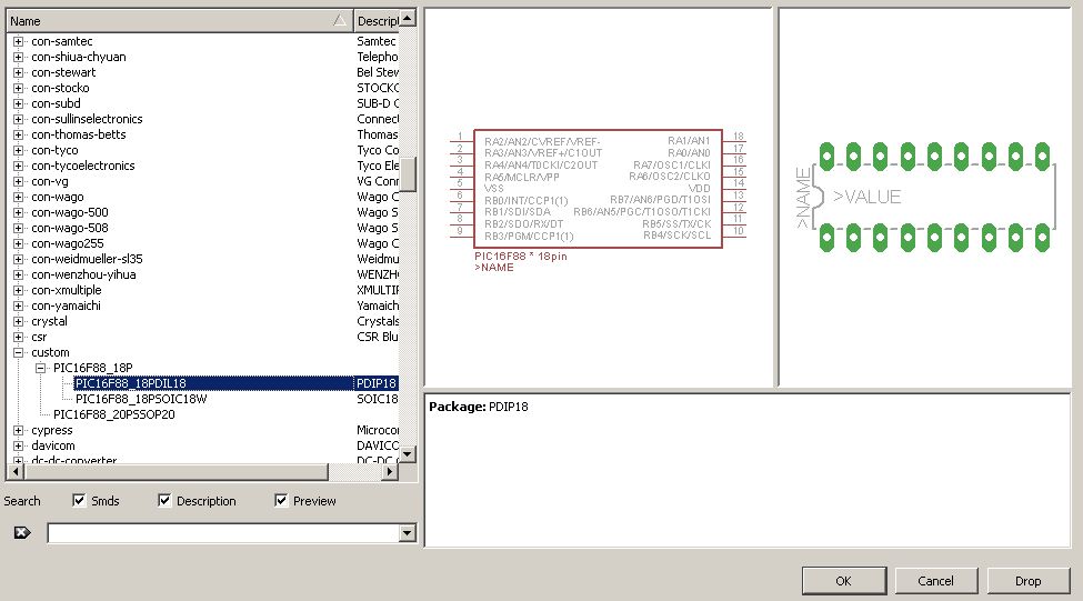

I Have only tried Nigels and im no good with making something like that work... but as for eagle i can Make you a part for the 16F88 if you want ? it will take about 3 minutes to do...
Ok i made it ill upload it now.. There are 2 versions... one is the DIP/SOIC which is 18 pins and the other is the SSOP which is 20pins...
  • custom.zip
No problem from me.... Bill has tons of usefull info on his schematics. I learned IR stuff from it and almost everything i know started from his Junebug...
the 16F88(18DIP) foot-pint is readily there, even in EAGLE ver5.5.0, under Sparkfun.

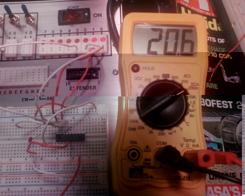

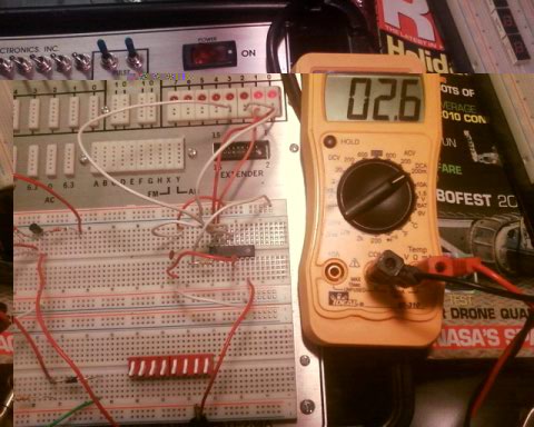

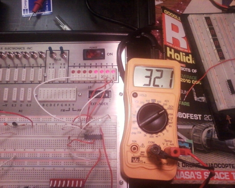

At the risk of this becoming a Blog, I have done more experimentation with the original circuit. I'll be the first to admit, I have a problem with letting things go. I hope no one gets irritated, and I hope others can learn from my mistakes. :)
To this end, I decided to take current readings around the circuit to see what I could see.
One of the things I'm most curious about is why the chip responds to itself and not the nice circuit I went to all the trouble of building for it. I can confirm that the timing and voltage levels are similar enough that it should work. That only leaves the current levels. So I took different current readings across the circuit., and found the following(with pictures).
Between the TX and the RX - 32.1mA
Between the collector and the RX(no signal) - 20.6ma(after I reduced the resistor between +5 and the collector to 220Ohms).
Between the collector and the RX(+10 volt source at the RS232 connection) – 2.6mA
I may be wrong but I think the 2.6mA reading means that the pin is never getting a good active low, so the chip is reading a constant lo, even in the face of a signal. It tells me the RX is providing a far more enticing ground than the circuit I've provided. I have looked at the firefly circuit for some background, and it seemed to be very similar to the one Im using, just with lower resistor values. I'm still looking into that.
Has this told me what I needed to make it work? No! Am I going to keep plugging away at it! Hell Ya! I've also spent some of my Christmas money on getting a max232 chip that should be here next week. When it gets here I'm going to hook it up, and if it works analyze it and figure out why.
