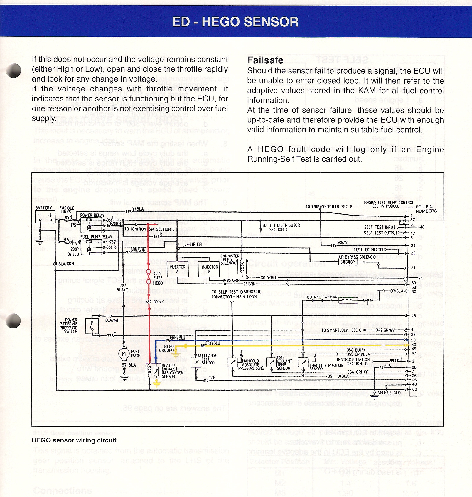

A bit of information on Lambda sensors from when I did an EFI course some years ago. One thing we were told not to do was measure the resistance of the sensor as it can be damaged. Only measure its out put voltage

Always good to keep in mind about damaging things.
