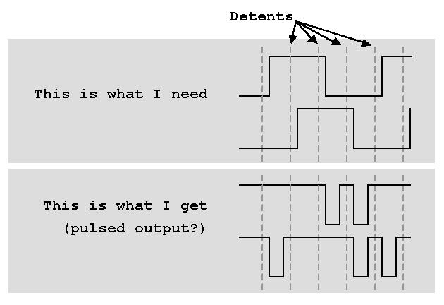

I'm having trouble locating a mechanical Rotary Encoder with built-in switch that outputs gray-scale values on the A & B outputs in the detent positions... The Bourns PEC11 series devices I received (from Mouser) and the Canon ITT NSE12 devices I received (from Digikey) only output the gray code on the A and B pins while the devices are positioned between the detent positions... Bummer!!!
Anyone know of any mechanical Rotary Encoders with built-in switch and detent in the distribution channel which output the A and B gray-code continuously?
Thank you Gentlemen... Regards, Mike

I'm not getting ambiguous results... These two different Encoders simply do not place the gray code values onto the A and B pins when the Encoders are in any of the detent positions... If I move the Encoders and hold them in a position between the detents I can read the correct data... Strange, huh?
My only 'clue' is that the data sheets for both Encoders say they provide "pulsed" gray code outputs... Unfortunately, I need steady state outputs at the detent positions for this project and I haven't found any Encoders at Mouser or Digikey that aren't "pulsed" Encoders...
Thank you very much for taking time to reply... Regards, Mike
I think many of these rotary encoders work like that, the idea is to use interrupts to read them, triggered by the pulses. By doing this it probably increases reliablity, the older ones (that gave permanent outputs) were very prone to random triggering as they got more use.
