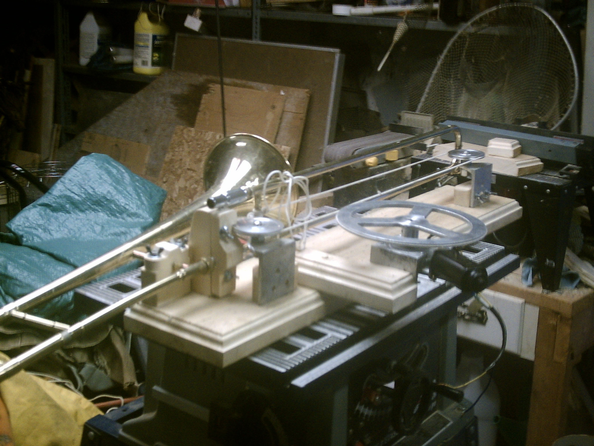

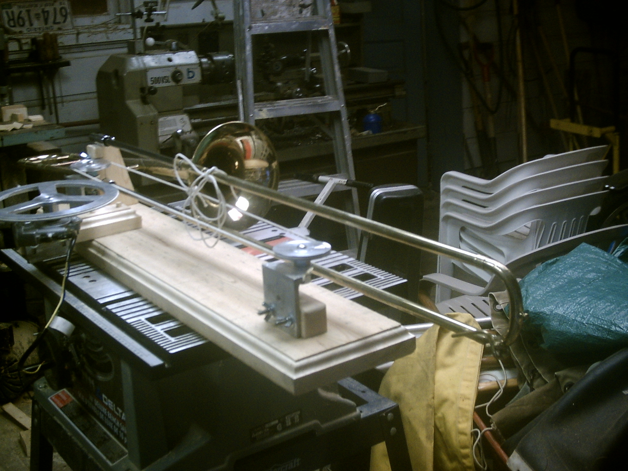

It's for position feedback for the slide motor (the big aluminum wheel in the photos) on the trombone robot I'm building. I've attached two photos, but I also have a short video if that helps. The video though is in .avi format, which I don't know if I can upload to the forum or how to convert it to a compatible file. Let me know if you know how to do that, and I'll upload the video too (it's less than 1 MB).
Right now I'm leaning heavily towards dknguyen's suggestion, since it's one I actually understand and is within my budget! Yes it's small, but I don't see that being a big issue for this application. In fact, the low inertia and the zero torque of the ball bearing option are a big plus. The only downside I can think of is the low sample frequency (2KHz for 10-bit analog). The slide's going to be moving at about 6m/s at its fastest, which will translate to 3mm accuracy per sample, but I think with some creative PID this might be acceptable.

The big pulley in the photo rotates just less than 360 degrees to accommodate movement over the entire length of the slide, that is, the circumference of the large pulley is just slightly greater than the length of the slide. For that reason, the pulley will never need to rotate more than once in either direction. I should say that the photos represent an early prototype - eventually the pulley/line will be a little different so that the line (actually two lines) are permanently attached to the pulley, which at that time have two grooves for separate lines in either direction. Sorry, I know that might be hard to visualize, but the short of it is the new set-up will eliminate drift due to the line sliding on the large pulley when it's in motion. What that means is that the position of the pulley will then be an accurate representation of the position of the slide (as oppose to there being the chance that the line has slipped on the pulley). The big wheel, at its fastest, will spin at about 600rpm.

The distance between semitones in terms of slide extensions on the trombone is approximately 10cm. With that in mind, each millimetre difference represents roughly one cent in terms of pitch tuning (or 1% of one semitone). I can't say for sure, but I think that for a human arm to be able to place an object within 3mm while moving at 6m/s is quite good, and like I said, I'll fiddle with the PID so that, for instance, if the trombone is playing a whole note it gradually moves the slide to a more accurate position. I think what this is all leading to is that there should be another kind of sensor feedback used for this project in the form of an audio tuner that can hear the pitch and respond to that for more accurate positioning, but that's a long way off at this point.
