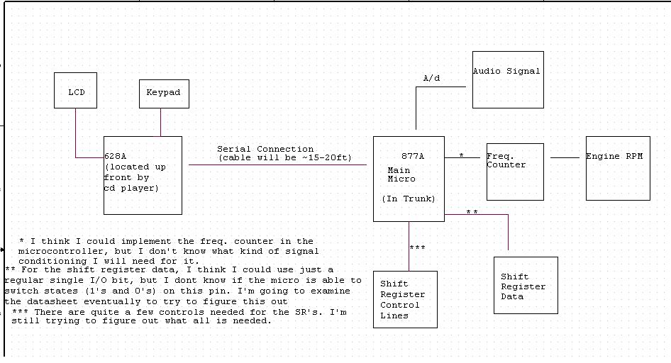

I'm going to use this topic to post the questions I have for my Roof Led project here.
I came up with this block diagram to try to sort things out.
My first question is kinda simple, for the serial connection between micros, what kind of cable will I need to use? and can I just connect the 2 directly, or do I need those max232 chips?
You can connect them directly, although I would advise you to use screened cable as it's running in a noisey environment.
A 1 wire LIN interface is not all that difficult to implement. Microchip has LIN interface chips, but you can do basic functionality with just some transistors.
You might not want to add even that complexity to it, if a regular 2 wire serial connection is working fine.
You don't need a max232 chip since there is no need to change the voltage to the funky rs232 standard levels.
Do you need to only transmit from one side to the other, or is it two-way communication?
It's also possible to use I2C which handles bidirectional comm on two wires, but you'd be deviating from the standard due to the cable length involved. By the spec, cable capacitance will be exceeded after just a few feet, but the PIC's pin's driving capabilities are much higher.
You probably want to look at how many wires are involved since a thinner cable is easier to route. Also putting the ends into screwclamp terminal strips (like Phoenix) will save you from having to do something like DB-9 which would have to be assembled on the car itself unless you can avoid the need to run the cable through small holes.
It's 2 way communication. I'm trying to figure out what type of communication I need to use (I2C, serial, ect.) I'm brand new to pics, so I dont know much about them. I've got plenty of room to route the cables I'm probably going to use those headers and sockets (0.1" pin spacing, like a hard drive connector.)
So I will be able to directly connet them with a shielded cable over a 25 ft. span. (that's the maximum length it would be). How many wires would that be? and what kind of shielding should I look for? The shield just connects to the chassis ground?

LIN is really made for this. It's an automotive 1 wire interface. It's pretty much just serial communications, but it's level shifted to 12v and protects the uC from shorts. It has a special protocol (which you can ignore most of if it's it's just 2 nodes) which allows multiple nodes on the line, and avoid collissions from more than one node talking at once. Microchip has plenty of LIN stuff, including app notes.
I've half implemented a LIN interface with a few modules on my racecar.
If it's simple direct connect serial, then you're using 2 wires, transmit and receive. Simply connect transmit to receive and the opposite.

I connected some LEDs up to the 82 ohm resistors I bought and those are unbeleivably bright. I think I'm going to need to make some sort of dimmer control for them. I was thinking of maybe an adjustable Vreg. I'll have to look into how the voltage is adjusted on them, because I would want to control the brightness using my keypad. I'm thinking of a digital pot.? any suggestions?
LIN is interesting, but not a big advantage to you if you're only communicating between the 2 devices. It gets interesting though, if you want to hook the LCD/keypad controller up to other modules that, control door poppers, run other lighting effects, horn tunes, or any other show car controls. You can have multiple modules around the car running different things, and controllerd by the one keypad/LCD unit.
If you were running the LED's directly from the uC, you could use PWM for full control of the brightness, but with your added hardware, I have no idea.
How hard would it be to upgrade from a regular direct connection between 2 pics to a LIN interface? I'm thinking since I got enough on my plate to keep me busy, so to simplify it a little, I'll just do a regular direct connection between pics. But I dont want to limit myself to any future upgrades. Although I might as well do it since I'm making PCBs for everything, and I know I wont want to redo them.

Here's what I'm doing: the 8 bits of the Shift registers are connected to a ULN2803 (high current driver IC) when +5V is applied to the input, the corresponding output is brought low completing the circuit.
Then I'm using 2 Vregs to give the leds the power (32 leds per Vreg, 20 mA apiece, = 640mA per regulator). Now I'm thinking that a simple solution would be to use an adjustable V-reg, (I'm not sure how they are adjusted, I'm assuming a resistor does the adjustments), if it is a resistor, I just connect a digital potentiometer and use my micro to control it.
Now a slightly more complicated idea would be to make an external PWM supply for the +5V for LED's. But I'm not sure as to what all this would involve.
Yet another solution would be to pulse the output enable of the Shift registers, which would then pulse the ULN2803s. Both the SR's and 2803s have quick turn on/off max times, so that would not be a problem (I think)2803s: 1us max (.25 us typical).
74hct299: output enable high outputs: 39ns (18ns typical) low outputs 33ns (15ns typical)
output disable time: high outputs: 46ns (24ns typ) low outputs: 39ns (20ns typical).
A downside to this is that I was planning on pulsing the OE for different patterns ect, so I would use this as a very last resort.

It's best if you look at the app notes on Microchip site.
I'm using a Microchip hardware interface for LIN. I think it's the MCP201. I'd have to double check. I remember in an appnote, it was shown you could do the hardware layer with just 2 transistors. Maybe it was a Atmel appnote. I'll try to find it.

I think I'm going to go with the LIN interface. There are a few other things that I will want to add later, how complicated will it be to add another micro to the lin interface? These added functions will be controlled by the keypad micro. So I know that it will have to be reprogrammed, but will I have to reprogram all the other micros so that this new one will work?
Also, how can I shift the data into the shift registers? When I was going to use the AVR micro, there was an app note that used the MOSI MISO SCK pins to shift the data. I dont know if these are the exact pins or not, but it didnt use just a regular data pin. Can I just use a regular data pin on the PIC, (say port A.3)? Or do I need a different method? (I2C?) How many I2C connections can you have per PIC?
