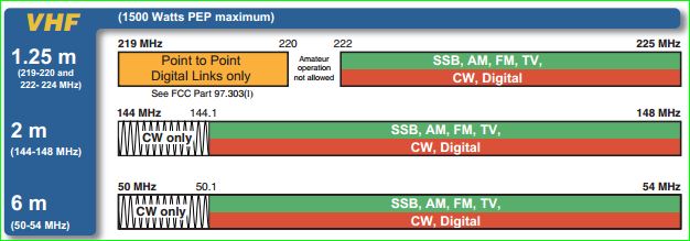

You are correct, the Technician license does not allow transmission in the FM band:
But Part 15 of the FCC regulations speak to "unlicensed low power FM transmitters" -
Unlicensed broadcasts on the TV broadcast bands are prohibited, except for certain medical telemetry devices, wireless microphones, and other 'low power auxiliary' stations with an output of 50 mW or less. 87.5 to 88.0 MHz is considered part of the VHF TV low band (channel 6 analog audio is on 87.75), though it shows up on most FM tuners. For TV, 15.241 and 15.242 deal with high VHF (channels 7 to 13), 15.242 also deals with UHF (band IV and band V).

The legality of what you are proposing is covered in this FCC publication. See the 88-108 MHz section of the Part 15 low-power transmitter frequency table, where the allowed field-strength for Periodic Transmissions is only 150uV/m@3m. Using the FCC's formula on page 29, the allowed unlicensed power output from your transmitter is P=0.3*E^2, or 0.3*150e-6*150e-6 = 0.00675W = ~7mW. If you stay legal, the power output of a FCC compliant transmitter is not likely to be very useful for locating the rocket after it lands, and is quite marginal even for tracking while the rocket is up. I would recommend a power output of at least ~100mW. If you choose to bootleg it, you are subjecting yourself to a $10,000 fine.
Good news, you can do everything you want to do and more if you get a US Amateur Radio License. Better yet, get know some local hams and get them to help you... Use the two-meter ham band. Sensitive receivers are cheap. Small transmitters are available in kit form. You can even use GPS with APRS to track the flight and final location on www.aprs.fi (recent flight)
For example, look at what hams are doing for ANSR.
