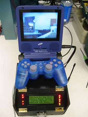

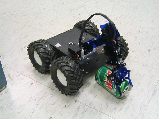

Been working on a Robot for about the last six monthes or so. Finally got it done.
The Robot was built to satisfy a senior design class.
The Robot is actually just a ROV that is controlled from a base station. The vehicle
has a range of about 250 feet in open areas.
Just wanted to see what people thought of the project.
Any comments welcome.
Attached are some pictures of the Robot and the Base station.
Thanks.
kingpin094

Very nice!
The image that is on the base station is a camera that is mounted on the front of the robot.
It uses four 100:1 gearmotors that push the massive 5" tires. The steering is like a
tank. Turning is accomplised by slowing down or reversing the inside track depending
on the turning direction.

Huh..there have been a bunch of ppl who have asked how to send video from a r/c robot..
what method did you use??
I used an off the shelf camera from **broken link removed**.
It outputs a standard NTSC rca video stream.

Is that robot being controlled by a PS2 controller? I've been trying to figure out that protocol for a long time. And what kind communications did you use to control the bot?
[edit] Say, kingpin094. Do you have a webpage for the project?

Actually the controller is an Sony PSOne controller. They use the exact same
type of communications as the PS2 just with les information.
Here is a good place to start with Playstation Controller interfacing.
http://www.gamesx.com/controldata/psxcont/psxcont.htm
The communication is done with a set of Lynx TX/RX modules. A rough version
of Convolutional Encoding and Viterbi decoding was used to do some forward
error correction. A 16-bit CRC was also used to prevent invalid data.
