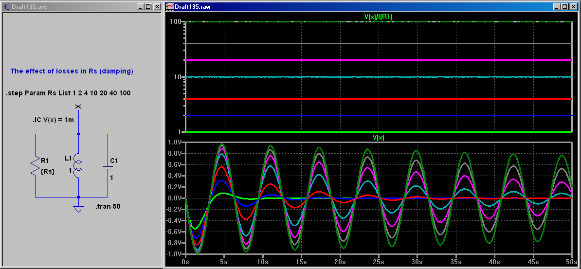

It dissipates energy. It is part of any practical LC circuit, mostly as core losses and wire resistive losses in inductor, and less so in the capacitor. A theoretical LC (with no dissipative R), when excited, would oscillate forever. With any practical (lossy) circuit, the oscillations die out due to the energy being converted to heat in the resistor.
Here is an LC circuit with a variable dissipative Resistor, Rs. Note the effect of varying Rs from 1Ω to 100Ω. The loss resistance can be placed in parallel with LC, or in series with L and C.

Thanks you very much, this is great and helpfull.
Ok I see that there is this resistance in L and C but is R used to indicate this resistance or does it actually exist? physically in the circuit. (you say it is a part of any practical LC circuit, so I guess it doesnt exist) If it does exist physically in the circuit, can you tell me in which case it could be used? I do get the reason why you would build this circuit without a resistor, but with a resistor I dont get.

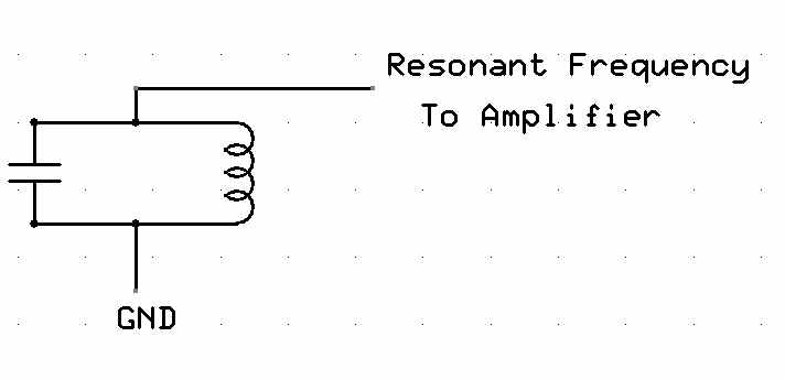

Sooo :) another quistion. Imagine I was to make a radioreceiver and I have made this circuit to receive only the frequenzes I want, as good as possible. Then I go the -3db down to find my bandwith. Is there any circuit that filter anything away that is less than -3db? So that the antenna would receive any frequenze it could , the LC circuit would filter most away, and there is yet another "box/circuit" that filters everything away that is under the -3db? It is easier for me to understand it if I see where it is used practically.
It isnt the LC circuit that give us only the frequenzies between the bandwidth but another circuit afterwards? Can anyone confirm this?

Hi
The way I see it is that the LC circuit is a hypothetical, ideal world scenario. However it would be incredibly hard to make, if not, impossible. A RLC is what you get when trying to build a LC circuit. The resistance that stop the oscillations continuing on forever comes from the inductor, capacitor leads, PCB tracks and various other unavoidable things. This is how I interpret the information given on Wikipedia and previous research.
The parallel LC (or in practice RLC) circuit will provide high resistance to all frequencies except the resonant frequency and a very small band around it. It will offer a low resistance to the resonant frequency, so it can be picked up by an amplifier. See the diagram.
There are many ways to receive only certain radio waves, that is just one. I have used it and it works.
Hope this helps
Tom
