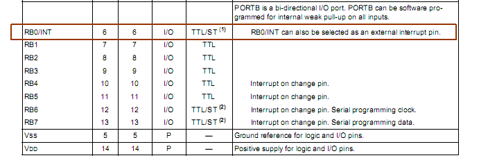

Look at interrupts on PORTB.0, it can be set for rising or falling edges.
