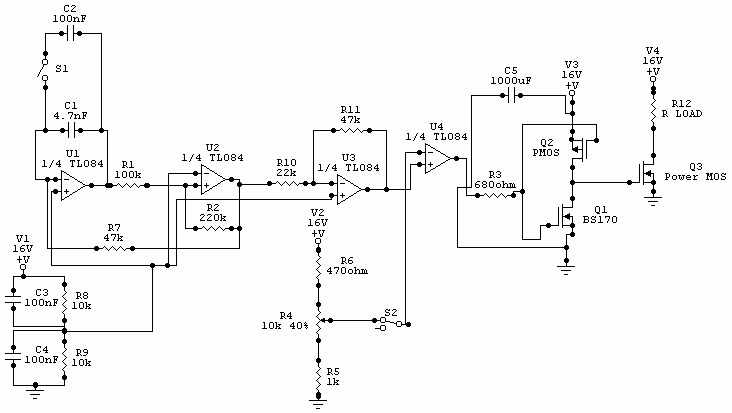

i found this in another thread, and this would be ideal. yet, i still have questions:
is there anything else i can use to replace q1?
does q2 have any specific value, or what kind it needs to be or a part number?
can i use a 60amp mosfet for q3?
The opamp produced PWM is not very fast so the driver Mosfets are not required.
The driver Mosfets would both be conducting over 1A through themselves when they are halfway switched.
Use the opamp output in series with 22 ohms to the gate of the power Mosfet.

Why bother with S2? are you ever going to open circuit the inverting terminal of that opamp? The circuit will behave erratic if you do... (read as: dont do it).. if you want to shut off the system, that's not the place to do it..

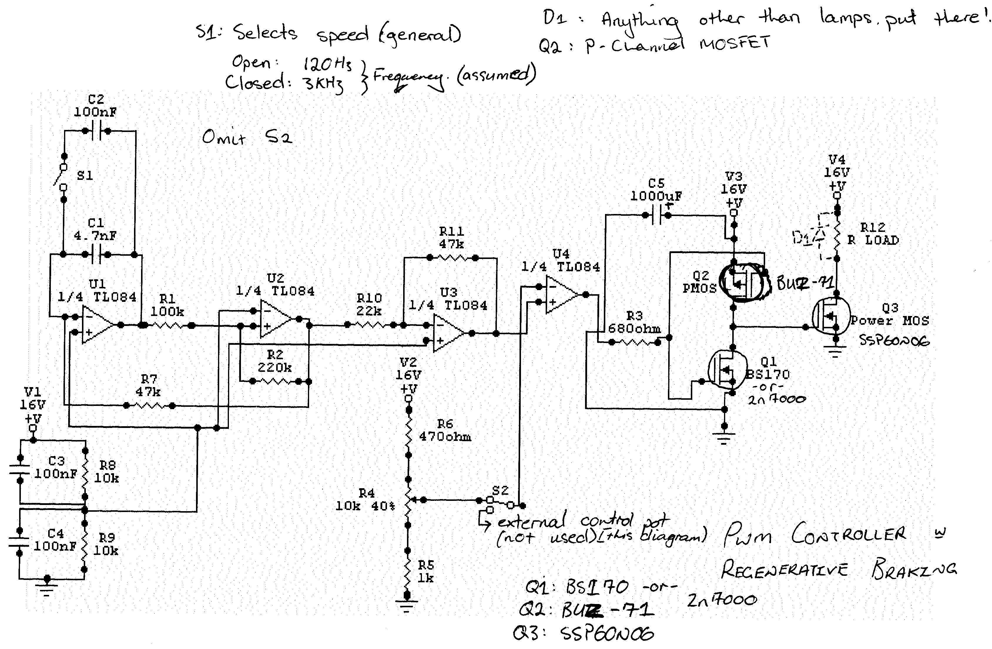

could i just drive q3 directly from the output of u4 via r3, or can someone please make a suggestion for q2? i am going to omit s2 (originally added for seperate pot to control speed)
here is the url of the original circuit:
https://www.electro-tech-online.com/threads/pwm-controller.21834/.
and there is a jpeg of the circuit, with my notes added in (scan of printout)

bunghole said:
could i just drive q3 directly from the output of u4 via r3?
That is what I said. Then R3 should be reduced to 22 ohms.
Q1 and Q2 were shorting the supply when they switched.
bunghole said:
could four MJ2955'S be linked together to equal one 60amp MOSFET?
An MJ2955 (and a 2N3055) needs a base current of up to 3.3A for it to switch 10A with a voltage loss of up to 3V. That is a lot of loss.
Use a Mosfet instead.
what would be the voltage of the output of u4, cause i was thinking of an SSP60N06,
Your driver Mosfets fight each other when they switch because they both conduct a few Amps through each other.
The frequency is very low so the fighting Mosfets can be replaced by complimentary transistors that provide plenty of current without fighting.
