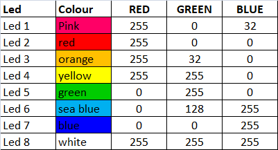

I'm in the last part of my project & stucked on it.I want to do a rainbow colour fade.See the video, it has 8 colums (8channels).I want same thing to do.
Needs to do the same fade to my 8 LEDs.Did a colour test on a strip & the values are in the excel table.
I want an idea how to shift colours in a fading manner...!!!

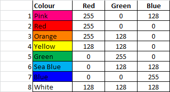

For simplicity I scale down the 255(R) 255(G) 255(B) values to 64 levels (64 levels indirectly represent full 8 bits using another table).So the code needs to deal with 64 levels.

Arranged the 8 colours in an excel sheet & find out the maximum increment from one colour to the other colour. For easy coding I found this value is 128.You can see in every colour change there is 128 levels. I incremented a variable upto 128 & compare with the "To Be Colour Variables".
Pretty long subroutine, but somehow it worked.
Note: That For colour Orange the HTML cololur values are RGB"255, 128, 000" , But for neopixels the orange should have RGB"255, 32, 000".
While colour changing I cannot see the colour orange is appearing.Because out of 128 fading levels the "Green 32 point" is 1/4th of my duty (128).
