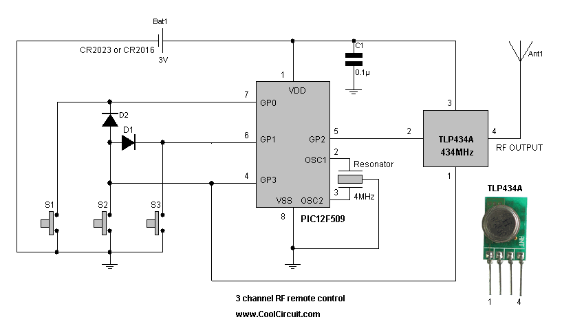

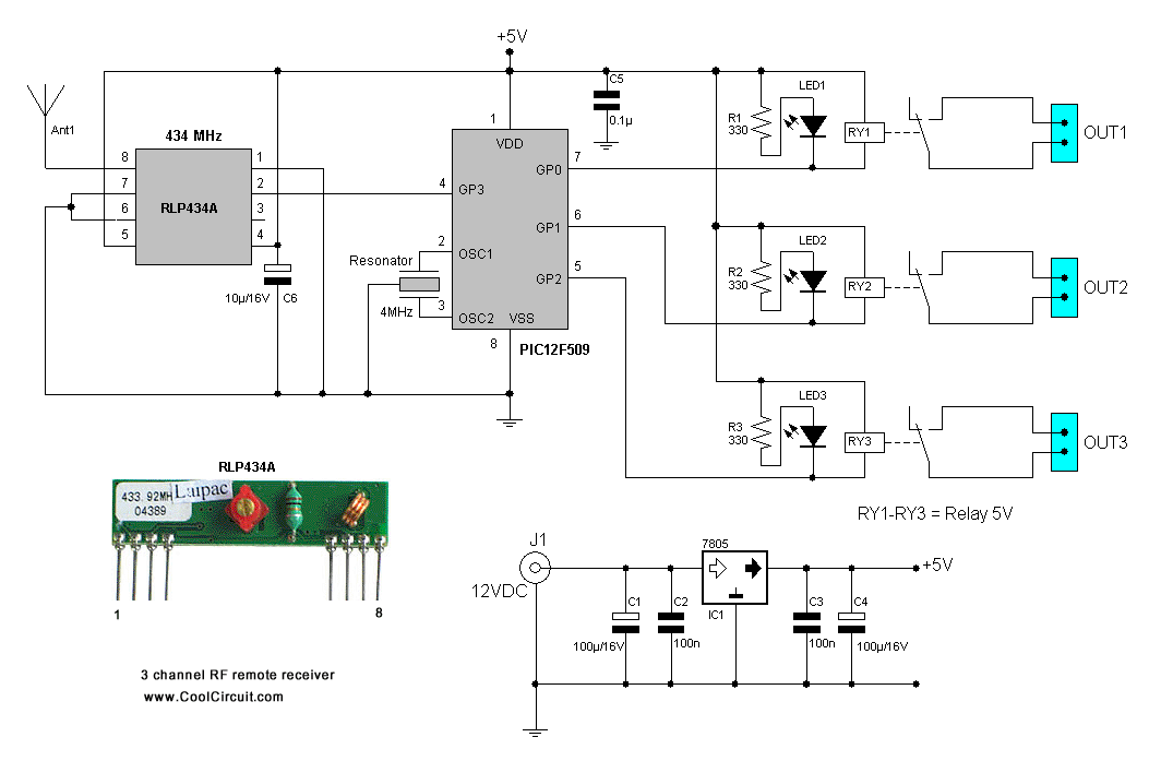

I need to know more about this circuit. My intention is to do a single shot to a relay to act a momentary contact.
Can you see any reason why it won't work that way.
I think I can at least build it. I'll worry about programming later.
3 channel RF remote control with TLP434A and RLP434Aproject
Here's the code. And diagrams.

In theory I don't see why you couldn't use this for your purpose. One thing I'm kind of wondering about though is that in the attached transmitter schematic the ground (pin #1) for the TLP434A is connected to ground through some pushbuttons. I think this is done to save power and stop the TLP434A from drawing current unless it's necessary. If S2 is pressed, pin 1 of the TLP434A gets directly grounded but if S1 or S3 are pushed it gets grounded through a diode. This will result in the TLP434A seeing a different supply voltage when S1 & S3 are pressed than it will when S2 is pressed. If the diode Vf is only .5V - .7V then with a 3V supply the voltage that the TLP434A sees will still be above the 2.0V minimum specified in the data sheet. I'm not sure if this will have any effect at all (maybe decreased range???). Maybe it's totally fine. I just thought I'd mention it.
If you want to cheat a little I have used these units with very good success. Basic keybob like automotive keyless entry with 4 buttons (one per relay). The relays can be momentary only on while button held or setup to latch where one button push latches the relay and the second unlatches it. They had excellent range of over 100 meters for me.
I used them as a safety device. When an employee enters a hazard cramped area they place a transmitter bob around their neck. Like the help I've fallen and I can't get up.
Anyway, something to consider in kit form with all the parts you need.
I only need about 5 to 10 feet it say's it's rated at 10m.

Now way back in the beginning I suggested a simple little RF kit. This is a kit I have used in multiple locations and before using it I called the company that markets it. They told me in good open conditions it would work for 100 meters. They work fine for me in adverse and damp wet conditions in a plastic NEMA enclosure at 100 feet (about 30 meters). Additionally they can latch and have 4 channels.
The only things I seem to understand is what Nigel is sayiing.
Ron
I need more than one Touch Activated location on a table. So, if I can wire a single series wire up to 12 locations on the table with the Battery operated Touch switch which will allow for that, it's relay will bring momentary closure for the RF Transceivers momentary PB and it's corresponding relay to being momentary for the end piece of equipment completing the cycle.
The key is the RF RX Module or circuit relay needs to be momentarily fired repeatedly like a one shot.
As stated above, the hole process will be repeated as many times as needed.
OTAY, makes sense. The gizmo I linked to will do that or using what was originally posted build your own. Either should work just fine.

Is it possible to eliminate the relay of the touch switch and feed Q1 and Q2 doubling the voltage into one of the PB simulating 3v at one of the 3 inputs? That would be ideal.
Question 1:
The " Battery Touch Switch " with a user single Touch I want both Q outputs connected directly to the TX Module inputs causing the TX to transmit
If I can couple the both Q outputs together to get the required 3v.?
Meanwhile, the RX Module will need to be able momentary close a relay with that corresponding signal.
Then this process needs to be repeatable as many times as needed.
I'm noticing that both the Touch Switch & the TX circuits require an earth ground.
Question 2: Is it possible to simulate an earth ground somehow?
