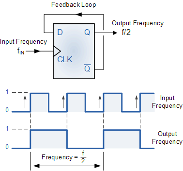

Hello Friends, I am trying to build 4 channel RF remote control device for controlling home appliances. I am using HT 12E & HT 12D. I have attached the circuits I am using, its working but not the way I want. Every time I press one push button or any of AD8 to AD11 makes low, the respective output on HT12D is going low. When I press another push button, its resetting the previous state and making only that respective output low. I want to operate these outputs independently. For example, I will be using one output for FAN and one for Light, etc., When I want to switch on the FAN, it should not change the state of light or any other output. Can someone please help me how to achieve this? Any ideas or help is greatly appreciated.
Try connecting the input of a toggle flip-flop (see attached) to each one of the two outputs of the HT12D receiver you are using. Each time a pushbutton is pressed and then released on the transmitter it will change the output state of the corresponding toggle flip-flop without affecting the state of the other flip-flop.
A CD4013 Dual D Flip-Flop IC has two independent flip-flops that can be connected to serve as two independent toggle flip-flops. One for Fan, the other for Light.
Of course, you will need suitable drivers for the fan and light since the CD4013 cannot drive them directly.

Scratch my previous reply. I looked at the datasheet for the receiver and the outputs of the receiver are latched, so repeated presses of the same pushbutton will not cause a change at the output of the receiver. You MUST send a different switch combination or the receiver output will not change at all. You can use a pair of pushbuttons, one for OFF, the other for ON, for each device you are controlling and use the corresponding outputs on the receiver to drive an R-S type Flip-Flop for each device.
There is a data valid output that changes state any time any button is pressed. That signal may be worked in for a different solution. I have to run now, though.

@ ccurtis, thanks for your reply, If I take this approach, I have to use two more chips for flip flops for controlling 4 devices and 8 switches (2 switches for each device for ON and OFF) right?. I am looking for a simple approach with just 4 push to make switches for controlling 4 devices, 1 switch per 1 device for both on and off. I have seen an commercial remote with works on PT2272 (I believe this one and HT chips work in the similar way) without any flip flops. So looking for the way how to achieve the same with HT12E and HT12D. Not sure if that is possible.

Without added external gates/flip-flops to the HT12D receiver, what you want to do is not possible.
