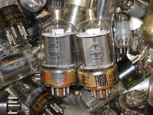

Ok, you win. I should have know better than trying to compare transmitters with an old scratchbuilder like you! The attachment is my lame attempt at atonement, showing my favorite transmitting pair. I used these in surplus Motorola 43GGT Tpower VHF sets as well as my Kenwood T599. This type was also used on my first tx, a Heathkit DX60. I'm sorry to say that all my homebrew has been other than receivers and transmitters. I got plenty of receivers and transmitters at work, 8 hours a day. Plus I am too lazy to take on big ambitious projects and usually end up buying something.
Micrel is a good choice for simple FSK.
