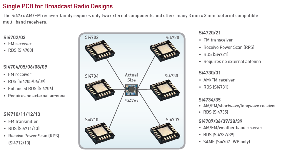

Can I get those in an IC package that i can just use
Here is a line of radios that use dsp.
