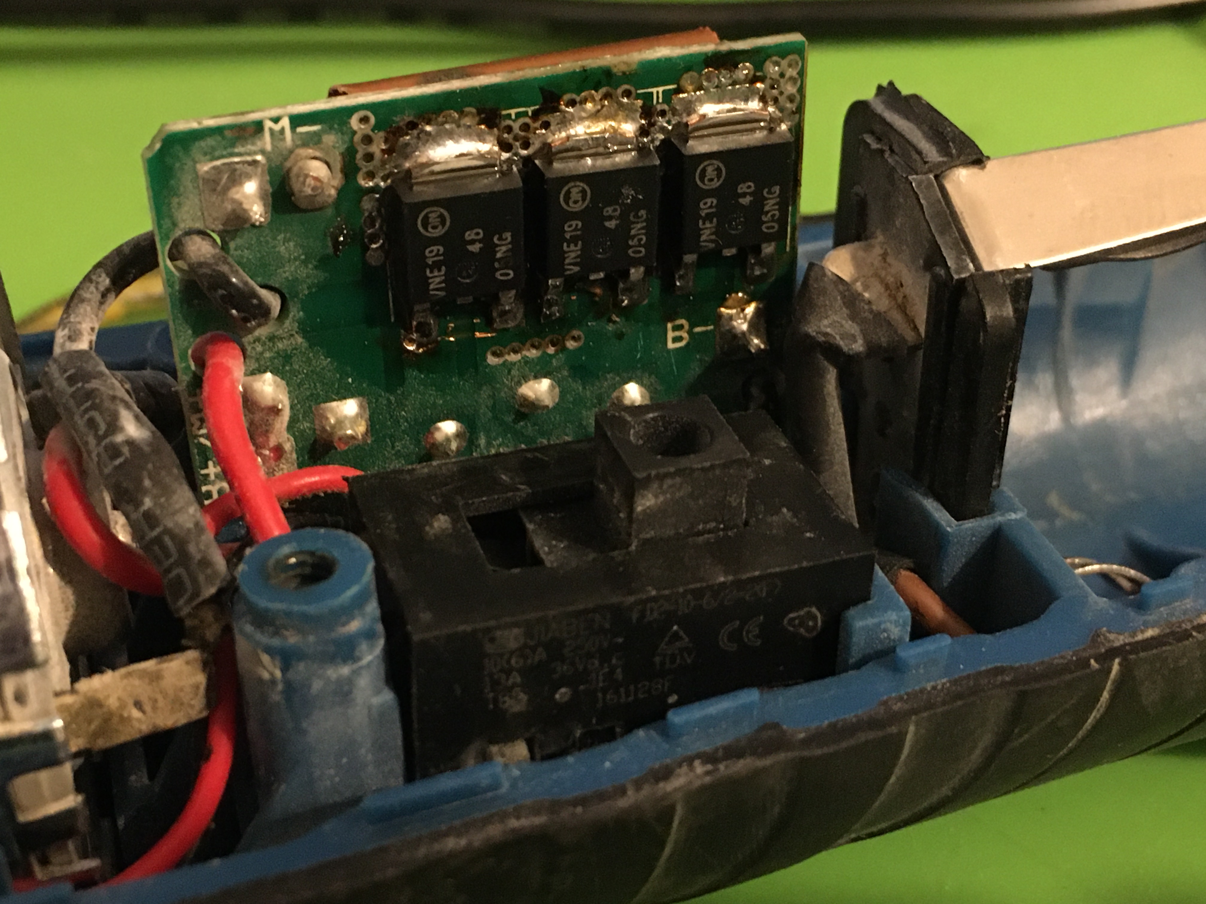

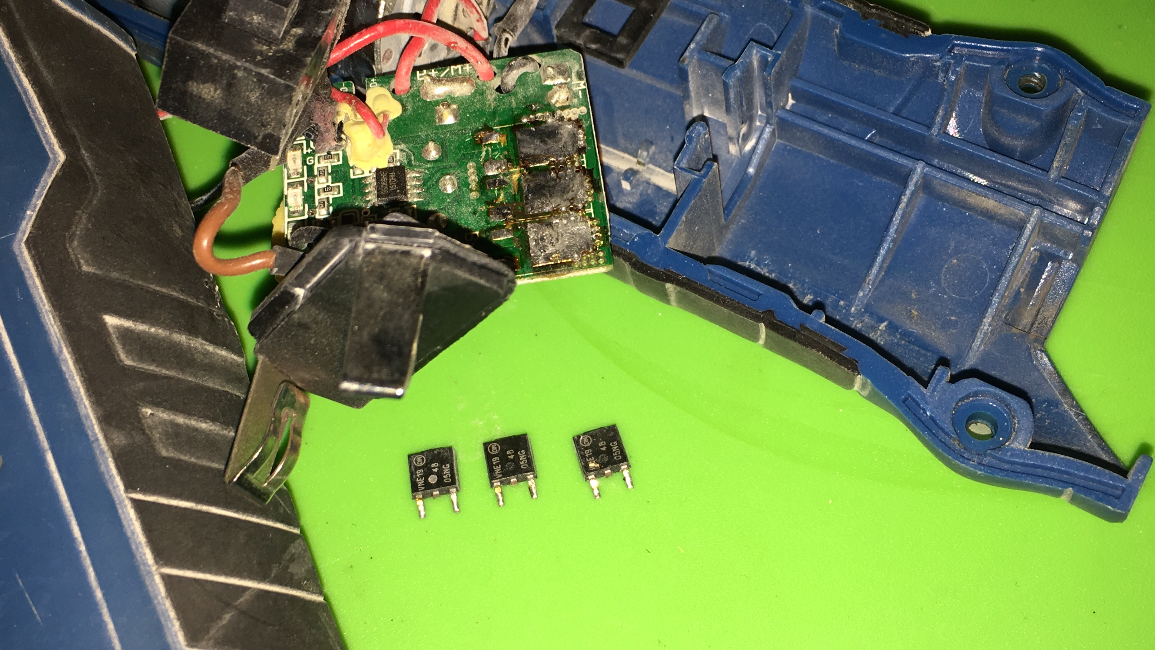

As it happens, I did something similar last night...
It's a multitool (oscillating blade saw) control PCB, which has three DPAK FETs and originally no heatsink other than the small PCB copper.
This is the second repair; the first time, it was obvious that one of the FETs had never been soldered down properly and it had cooked itself, then the others overheated and failed.
This time all three overheated evenly - and fell off completely!
For the previous repair I just used a normal iron set to maximum heat, tinned everything first and reflowed one at a time, as you describe.
[Edit - reading your post again, I cleaned the excess solder off with a solder sucker & wick before re-soldering them, though, and just added enough extra while everything was hot to give a visible flow around the device].
This time I coated the board with flux gel, arranged it dead flat with space below, put the new FETs in place and reflowed it with a hot air tool (a cheap thing I got off ebay some time ago, but it works very well).
First heating at a distance from below to get everything reasonably hot, then concentrating on the FET area from above until the solder under all of the FETs visibly flowed and they pulled down to the PCB.
(And this time I added a bit of folded copper to the back as an extra heatsink).
You can see it is a tiny board, but even with a hot air tool that has a nozzle about 10mm or so diameter, nothing else melted.
I'm glad you asked this question - from the photos, I can now see there is a bad joint on the motor wire connection next to the FETs. That's not going to help with thermal problems!
