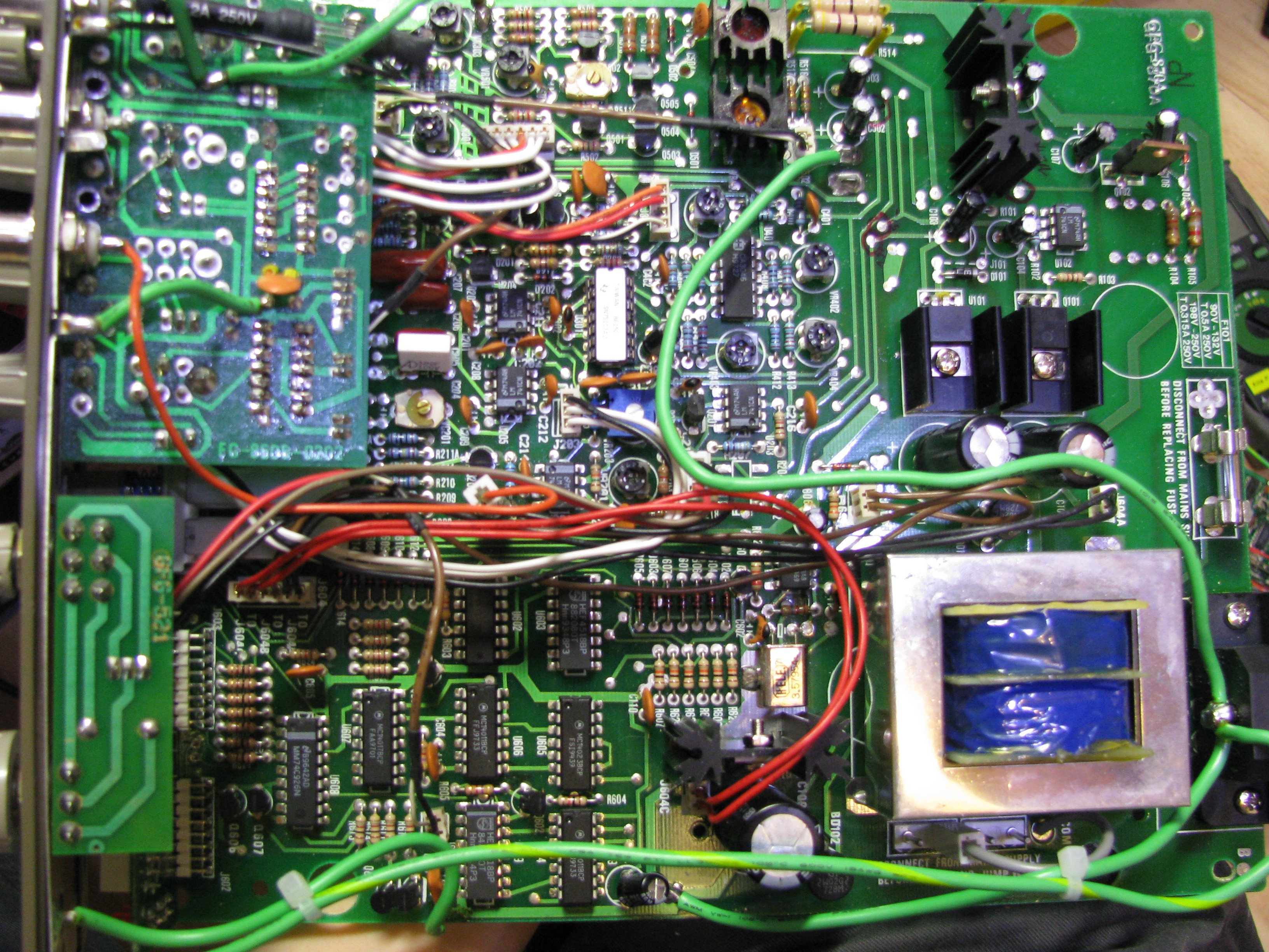

full circuit

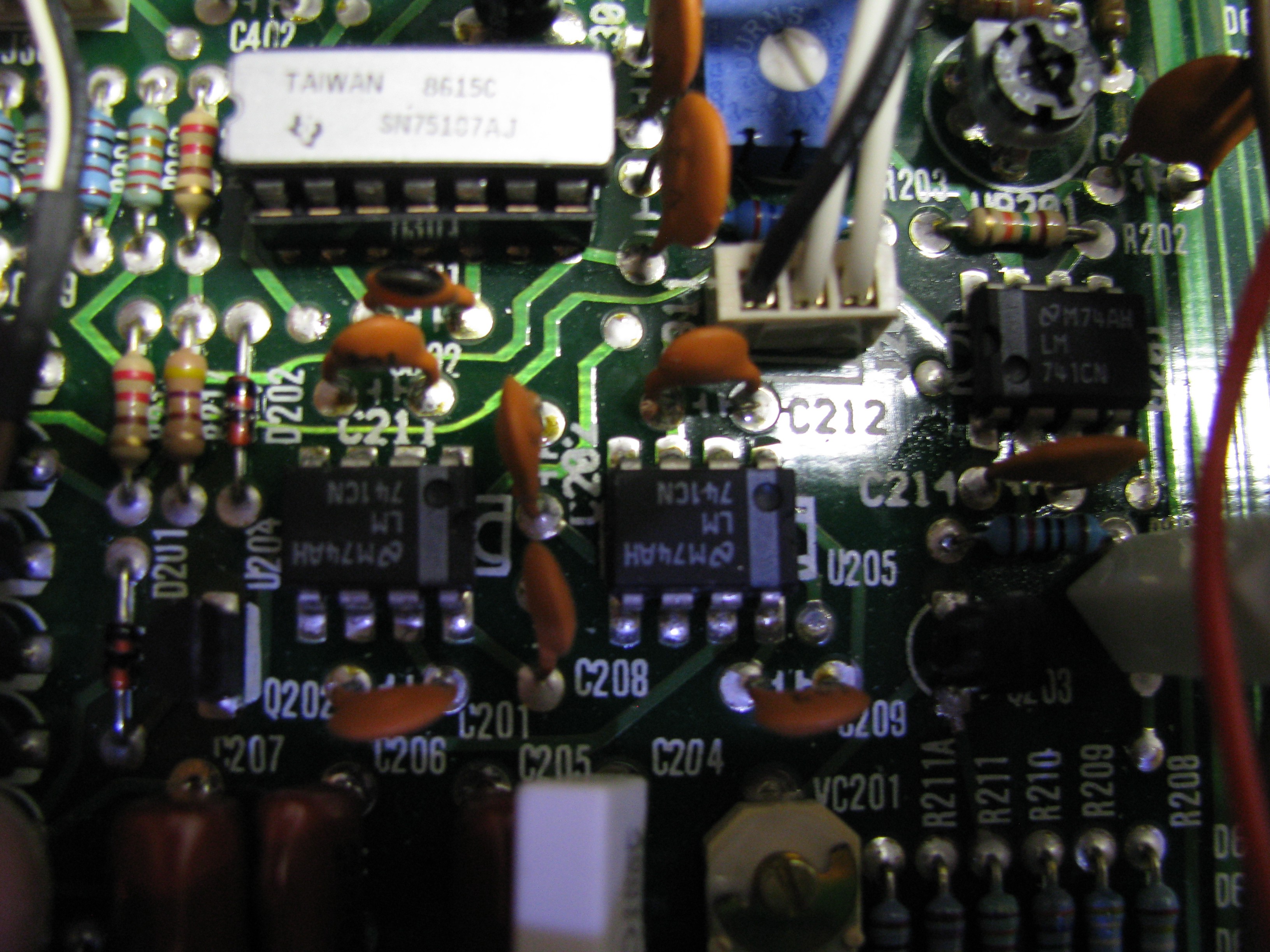

and positive/negative constant current sections, as well as VCF control (rightmost '741) and changed ic that had short inside, U301 (75107)

only line driver 75107, which was earlier AN-suffix (plastic case) is now AJ-suffix (ceramic) and ca3046 transistor array are what measure differ from working units.
Then again, i can live without TTl/cmos output and fully-adjustable duty on other unit

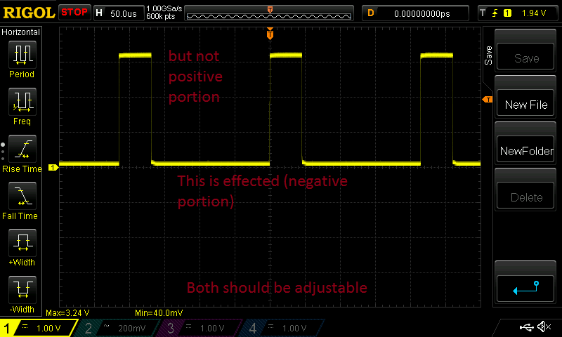

Then, the duty cycle, it effects only square for both positive/negative portion, but only positive/rising for triangle/sine, so it can be used to create sawtooth or slow-rise sine. THIS is how it behaved in working unit.
Now on faulty, sine/triangle work as in working one, but in square, only positive portion is affected.
Couple more observations: duty affects TTL's only negative, while CMOS's only positive

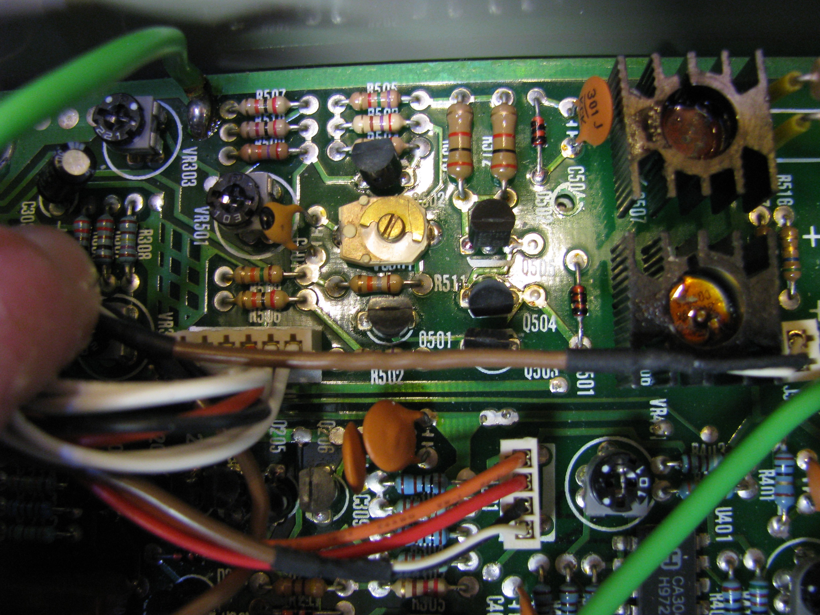

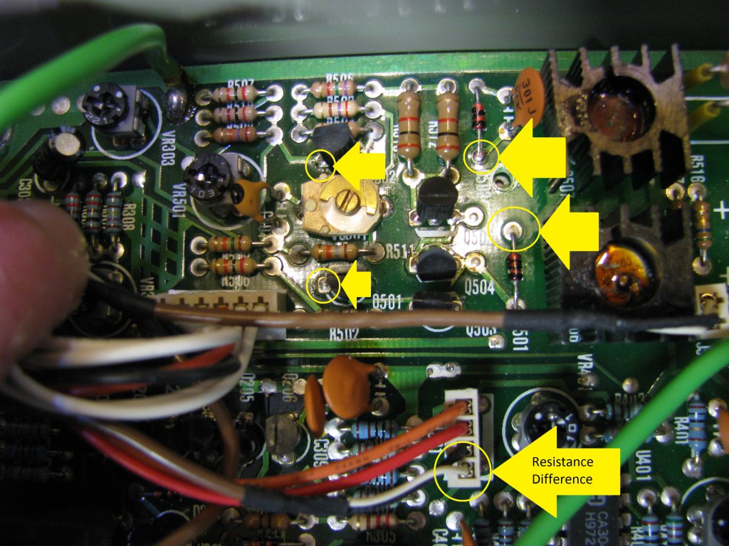

i've checked all semiconductos and none busted were found. There seems to be short/leackage somewhere in circuit as i measured connector that is related close to amplifier section, working one has several megs of resistance, where faulty has only 870 ohms!
also, base of amplfier start-transistors, as well as diodes at the end of it won't show change in postive portion of signal, only negative, where in working one changes both portions.
Also, lower of those bigger transistors on right get very hot after while, something cooks it. But they get hottish in wokring one too. Tested those transistors and they tested ok
there were also difference betwen upper-lower at leftmost two transistor bases measured to ground, lower ones measured as 780 ohms from working, faulty had 220 ohms

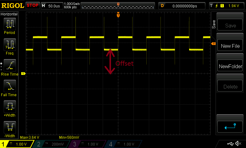

cmos has offset of +0.2volts to 0.5 volts when cmos is selected, depending on output amplitude (lower amplitude has more offset, at full amplitude lower, so offset changes inverted-fashion; amplitude up->offset down). When TTL is selected, offset changes to +0.32 volts solid

That problem might be partially between the instrument and the chair. You don't have control of offsets with TTL or CMOS. VR302 will set the max output in CMOS mode. If U303 (CD4081) https://www.futurlec.com/4000Series/CD4081.shtml is degraded, that could affect CMOS offset. You could check it at pin #11 or #2 of U303.
The offset TTL seems fine. TTL meant 5V when it was invented. You won't find 3V3 TTL.
other more severe is that only negative portion of duty cycle is effected
You need to better explain. The CMOS offset isn't low enough. It should not be adjustable. Points to U303, but check pins (11 or 2)
This offset i mean at CMOS output (taken from output jack)
pin 11 shows only 80mv offset, much lower value than this
I mean duty cycle for PWM values for square wave (shot taken from square wave output, not from TTL/CMOS)
CMOS offset: U303 should fix that problem. Set to TTL. Pull U303 (you said socketed) and measure R312 & R314. I don't suspect anything wrong.
