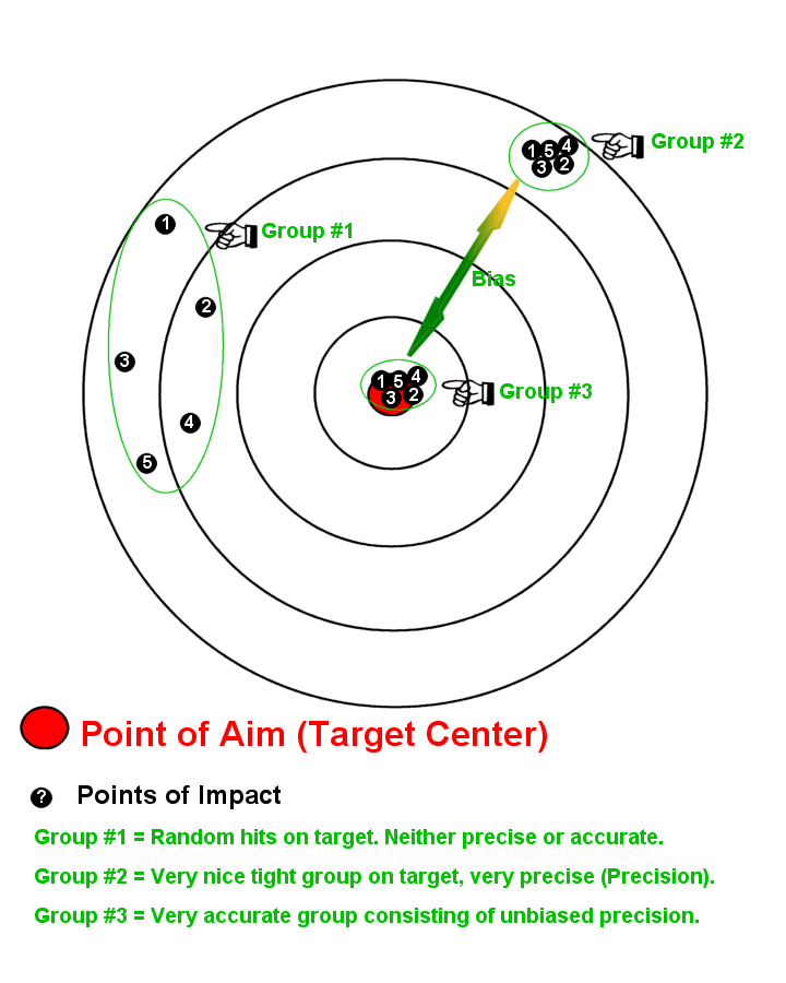

I have always defined, in its simplest terms as resolution is the ability to read an instrument or of the instrument to be read. This takes the term resolution to back before a digital display or an analog to digital conversion. That said when choosing an instrument for a measurement process Resolution and Accuracy (or uncertainty) both figure into things as well as resolution.
As to defining accuracy? I like to define precision as a high measure of repeatability and accuracy as unbiased precision. The following image illustrates this fairly well.

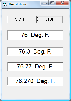

Anything at all to the right of the decimal is not worth considering. I can have resolution out 6 places to the right of the decimal but the numbers will mean nothing. It will however, look pretty cool but that's about it.
