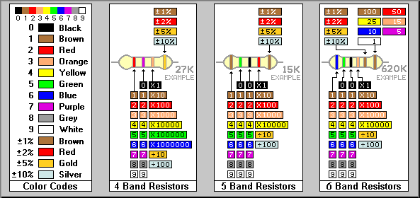

Resistor value chart attached, hope it helps
Cheers, Rodalco

Rodalco,
Re: The chart's 6 band resistor colour code
What is the sixth band used for? The chart does not say.
I think there is an error too. I see the 6 band example as 650K, not 620K as stated.
Bob

Well spotted Bob, never saw that fault in the 6 band resistors. You are correct, it should read 650 k.ohms.
I plucked the chart somewhere of the internet.
I don't know where it is for, because i have never seen 6 band R's. perhaps Google knows.
It is temperature coefficient.
