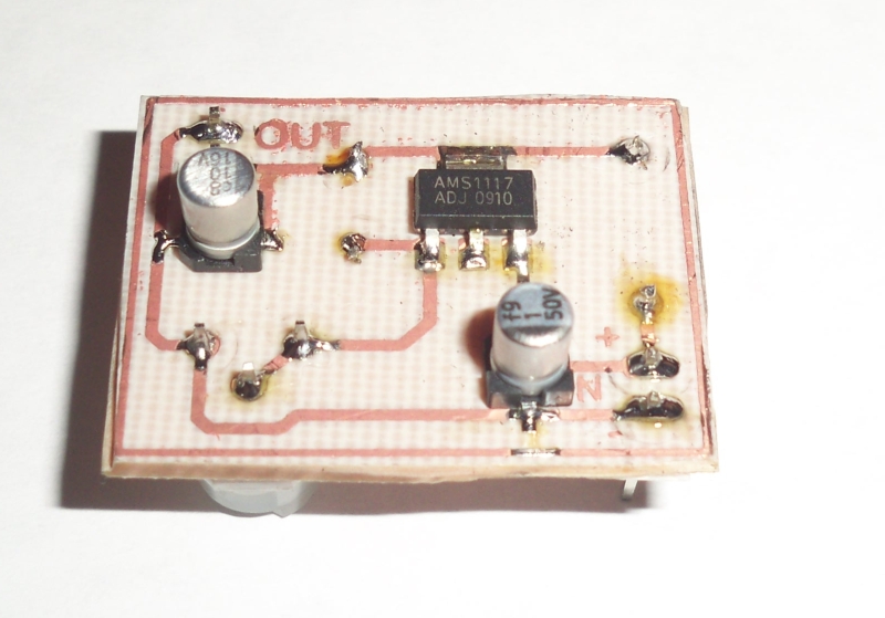

let me better explain what im trying to do. I am using a AMS1117 voltage regulator but for some reason it smokes up even had one blow. Im trying to create a ADJUSTABLE 3v-12v 1A supply... 1A or less really
the most this IC can output is 1A so i dare not stress 900mA on it. I want this for basic small powering devices
Depending on what the circuit is pulling maybe 500mA. What size (watt) resistors should i be using?

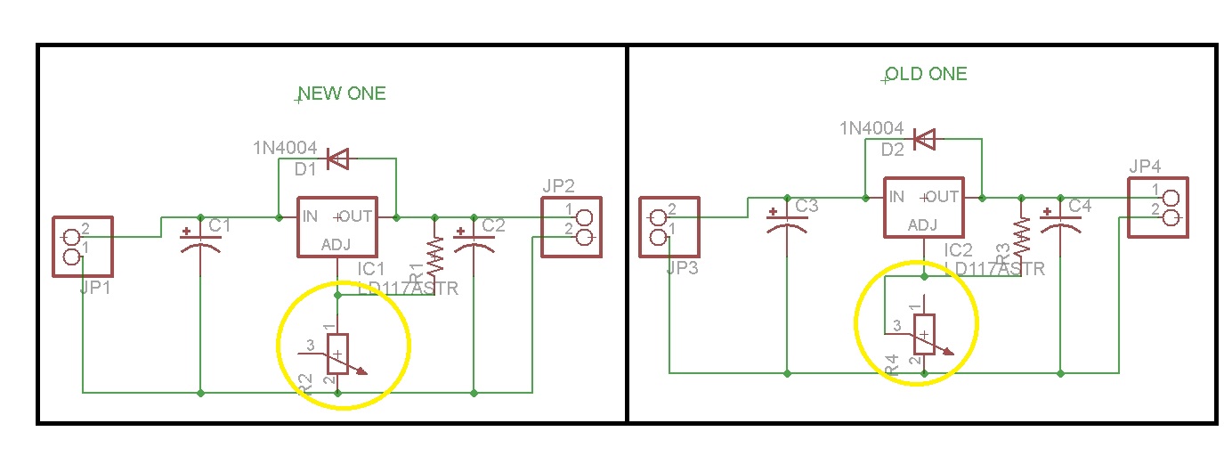

look at yellow circle the pins from POT:
The OLD one is correct. Slightly better would be to connect the wiper to the top terminal. The NEW one will not allow the voltage to be varied.

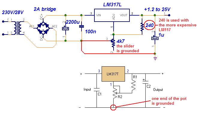

Wont work as a voltage regulator. Why are you trying to reinvent the wheel? Use **broken link removed**.

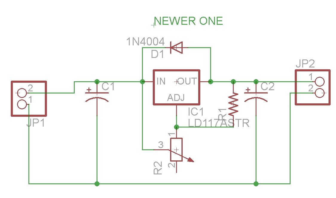

Both those are wrong then?
No, both circuits return the bottom end of the adjustable resistor to the negative rail, not to the unregulated positive input like you showed in NEWER!

The pot must have one terminal connected to ground like shown.

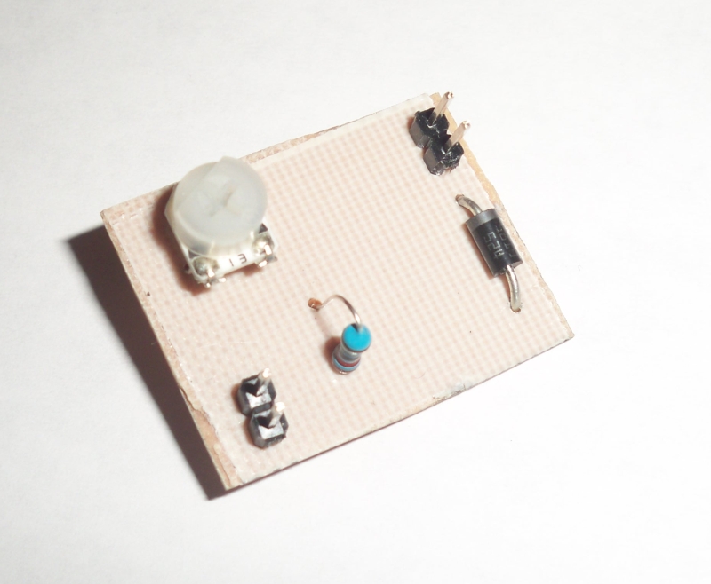

Here are a couple of pics of the TEST BOARD (which i will still use):
powera-jpg.43667
powerb-jpg.43668
