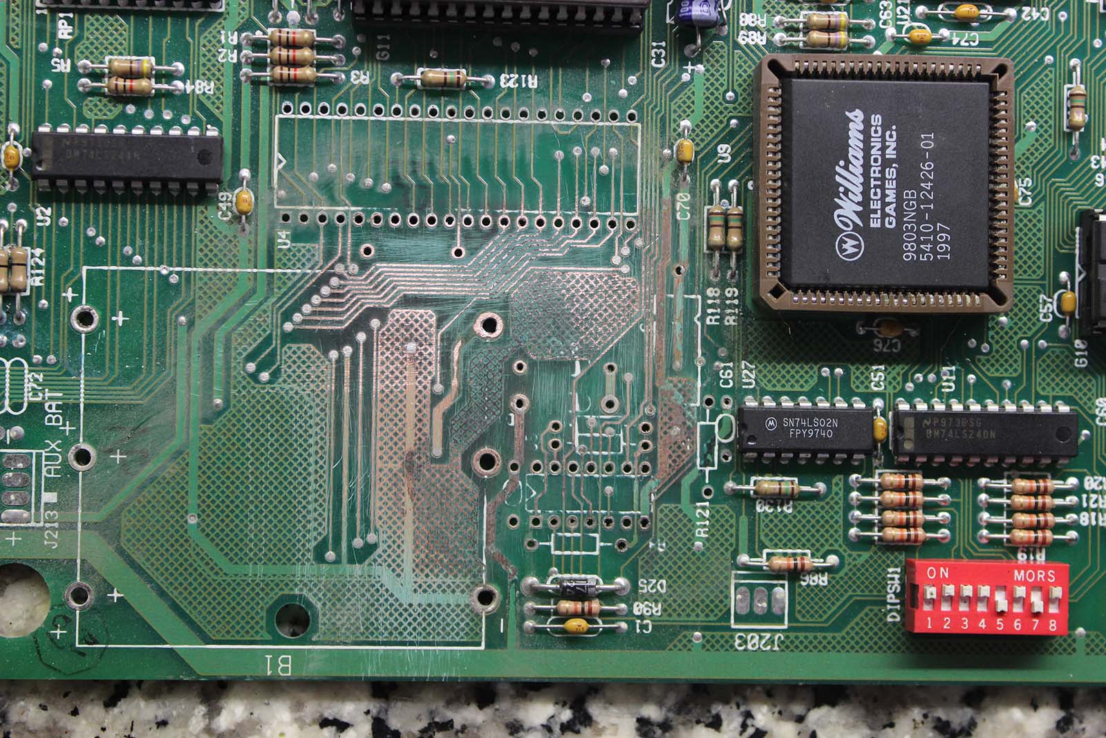

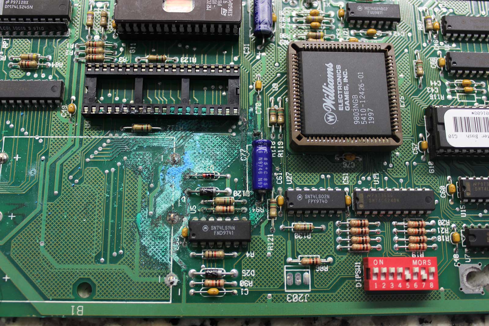

I have a pinball machine (Monster Bash) that I also repaired due to battery damage. The nice thing is that everything was on a 0.1 inch pitch then so easy to unsolder.
This is what it looked like before removing any components.
This is after the removal of components and a first clean attempt.

I did eventually have to replace the asic socket as well. Interesting stuff.

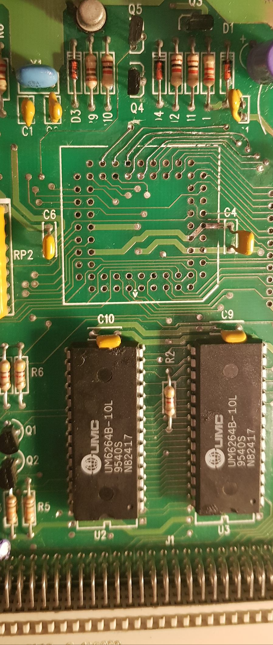

I'm working on this... it's a ram/Cpu card my first ever repairs there were 98% successful. It booted a few times but was not quite right. I've checked the microprocessor and pal chips work in another card. I can't find any other broken tracks with my meter so I'm changing what components I can. I'll give it another metering for a week too. Learning a ton of new stuff doing it though!
Looks like your damage wasn't as severe as mine but your damage was under the 84 pin PLCC socket (same as the asic on the right above). It all worked eventually - thought I'd get away without replacing the PLCC but had to anyway. Working on boards from that era is good fun, very satisfying and I'd go as far as saying relaxing. If you look at any modern board the skills required to replace anything on those is far way higher and sometimes impossible. Good luck, it's oh so rewarding when it eventually springs to life.
