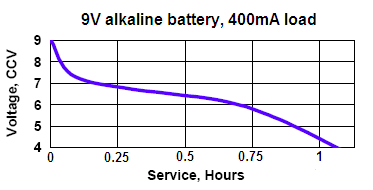

So what's the e.m.f for a PP3 Battery then? If its my power supply then how much do you think I can reliably dissipate before its internal voltage becomes a limiting factor (just an example)
A PP3 alkaline battery (most know it as a common 9V) will have a terminal voltage very close to 9V when new. If you draw 10mA for a while, its voltage will fall to about 8.4V. As it goes dead (flat) it will begin falling more rapidly. If you draw 100mA it will fall more quickly and most brands will be dead between 1 and 2 hours.

Here is a graph of voltage vs current and time for a 9V alkaline battery:
