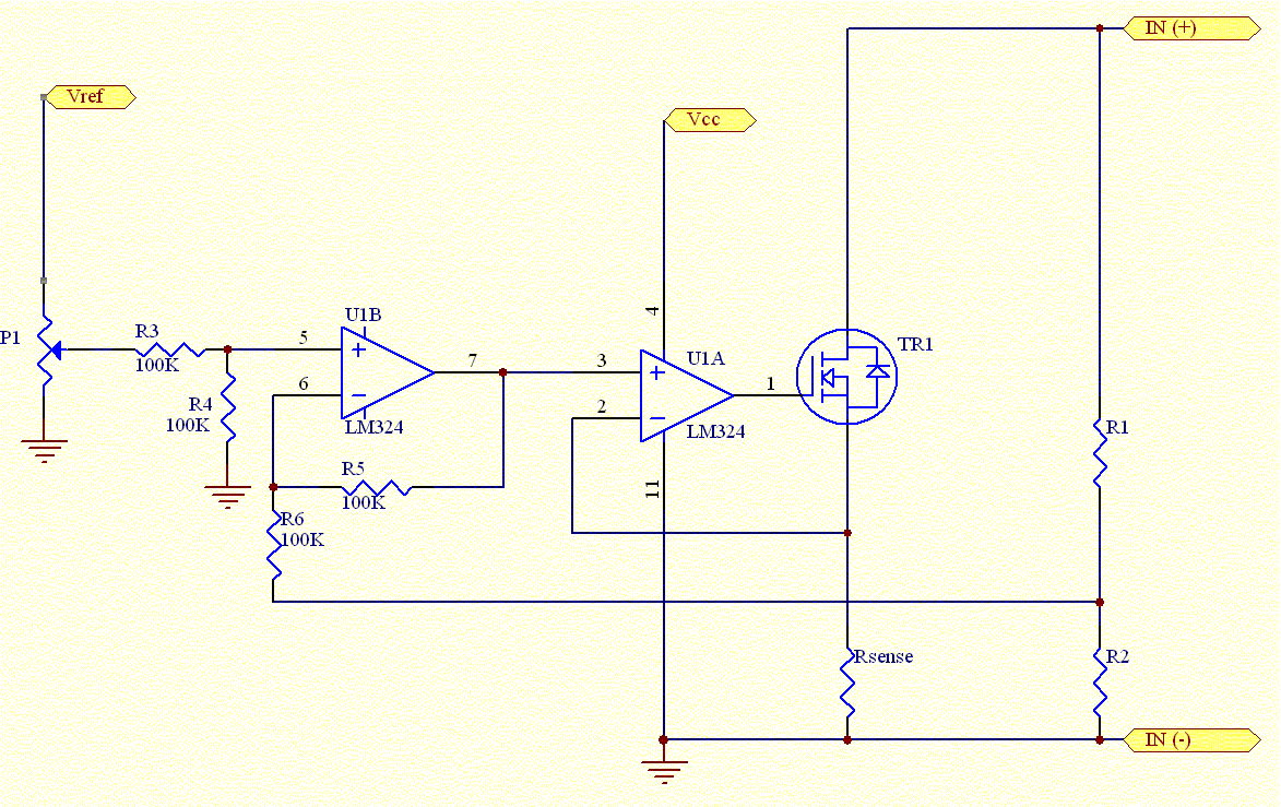

I am an MSc student in power electronics. I need an idea how to design an electronic load. The behaviour of the load should be "Resistive"; not constant current type or other. When voltage is increased I want current going throuh the load is increased as well. There is a pricipal circuit attached, i am not sure how precise it works. But i need other ideas as well.
Thanks in advance.

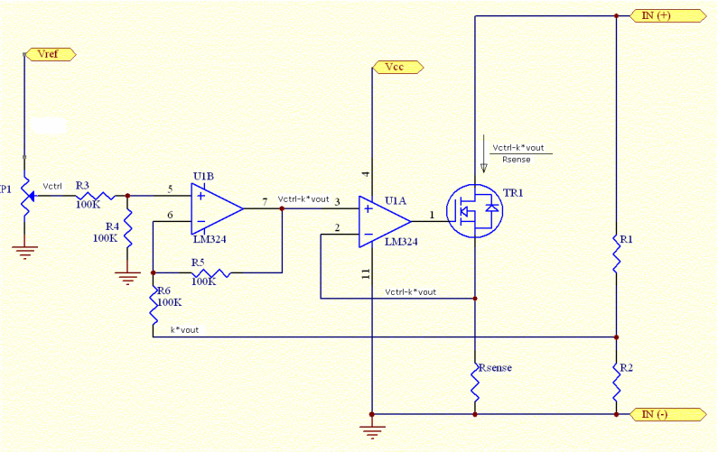

See the annotated schematic below. Note that, as the output voltage goes up, the current goes down. That's the wrong direction. You need a function with the form
Rout=Vout/Iout=k*Vctrl
Solving for Iout,
Iout=Vout/(k*Vctrl) or Iout=k'*Vout/Vctrl.
It looks to me like you need an analog divider, or perhaps a microcontroller, if you want DC current. If you can tolerate PWM, a microcontroller is still probably the easiest way to implement it.
If there is an easy way to do this in purely analog fashion, maybe one of the other guys here knows how to do it.

First of all i have to confess i was not waiting replies in such a short time. Thanks a lot. Regarding your questions;
*) What i need is a "dummy -Resistive- load". Now i develop SMPS in different topology for my research project and i want to test some parameters such as cross regulation and efficiency at different output voltages.
*) I need dummy load for DC operation and i generally work voltages higer than 5VDC.
*) I thought using a microcontroller to simulate "R" (V/I) function but i just wondered if there are some other easy/cheap and easy to implement ways to do that without using a micro or a complex analog division circuit.
*) I used current source model, it woorked very nice but if i increase the voltage, lets say double (or half) current still remains the same becasue of current source structure. I needed someting to draw say 1A at 5V and if the voltage increased to 10V current should be 2A; simple resistor which i can program the resistor value.
I have not used/thought about using transistors in the simple dummy resistor circut. Do you think it offers better performance with a simple insulated base curent bias?
Thanks in advance,
