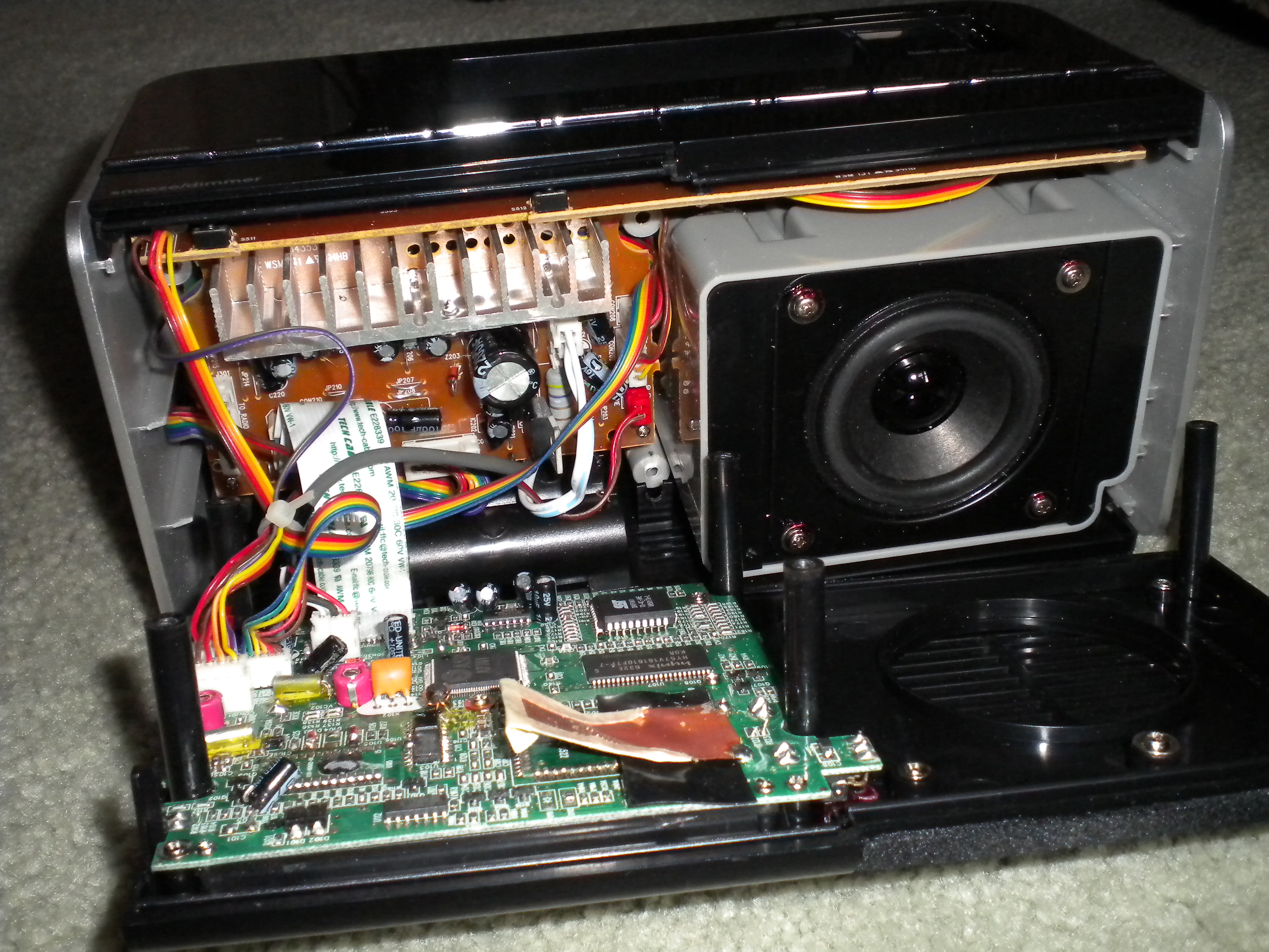

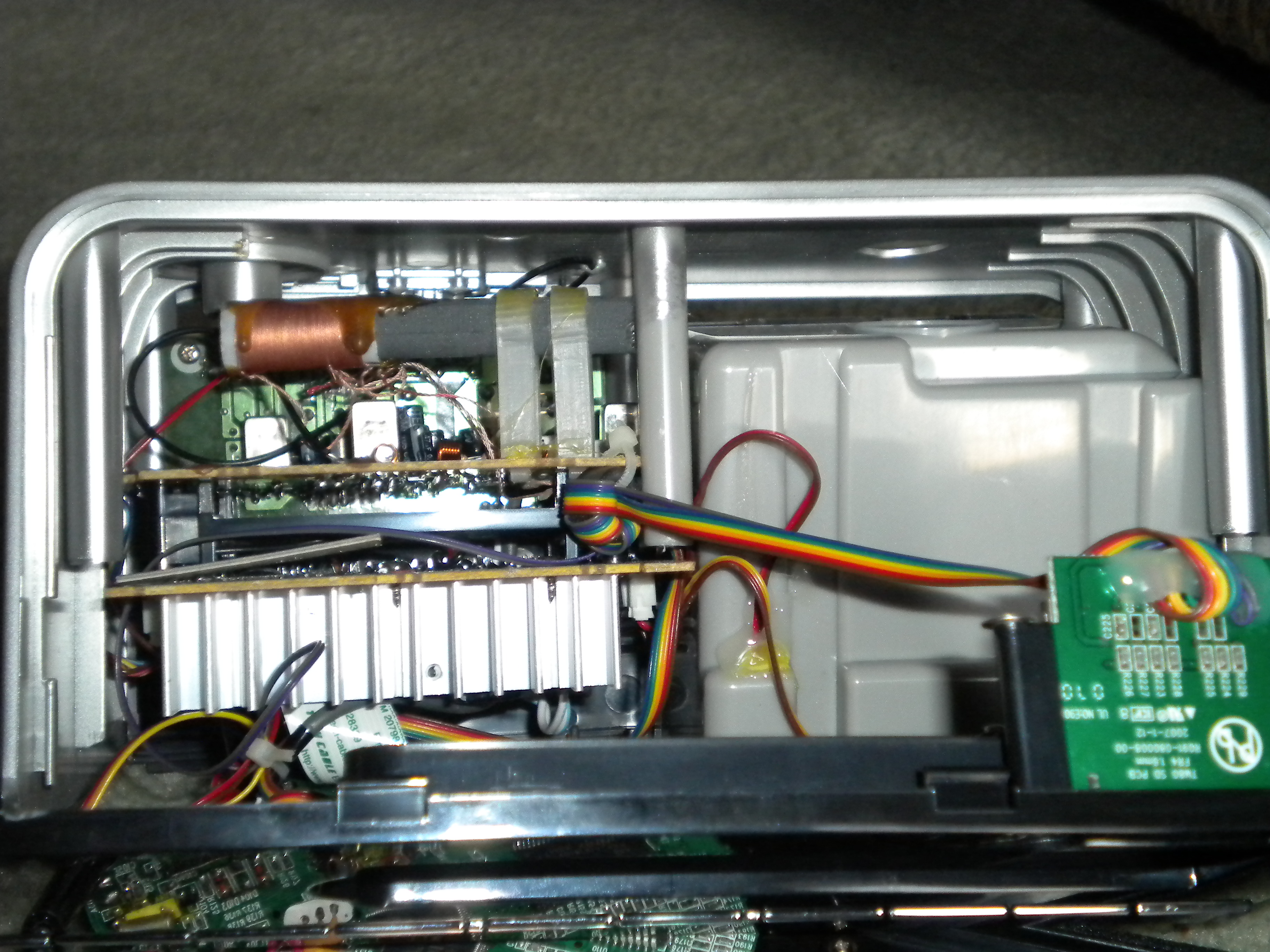

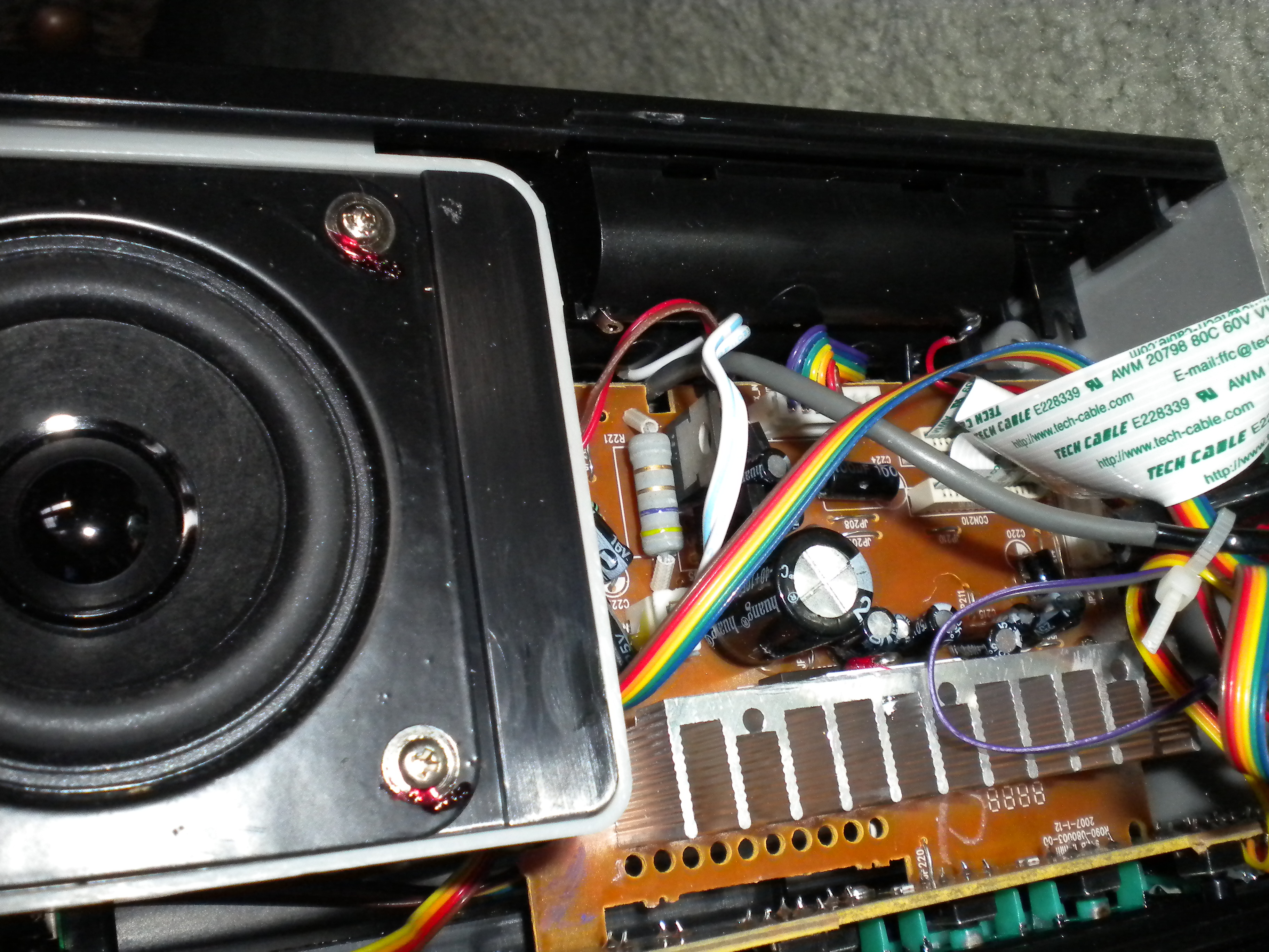

Ok! We got the screw out and now we can take a look at the inside. Looks complicated to say the least. Should I post some pictures?
Pictures of the alarm clock!

I could not see anything that looked like a buzzer in the photos.
Have you located it?
Do you have a multimeter? If not, can you buy a cheap one or borrow one?
Do you have anyone who can give you advice, such as an electronics teacher at a college, TV serviceman, etc.?
If not, we should be able to guide you anyway, but it would be much easier for you if you could obtain some advice in person.
