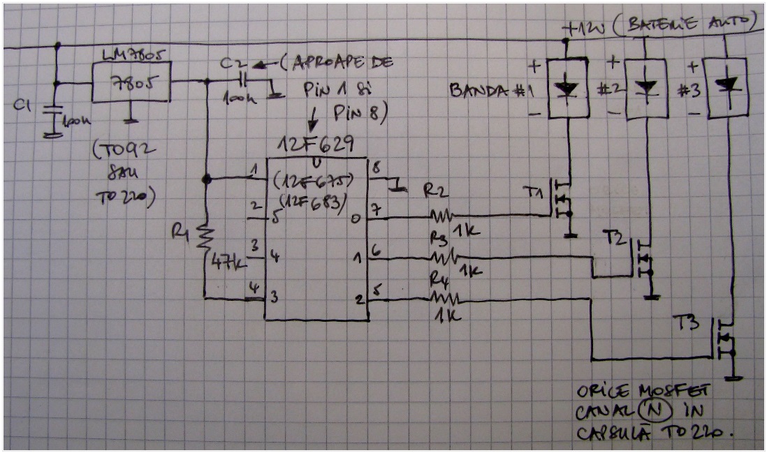

- operating voltage is 12-14v, i'm trying to switch my taillights from bulb to led with a personal design, the strips are not big, 21 smd leds with resistors at every 3 smds
I've been looking alot for a solution to my idea as simple as possible .. i've attached pictures with what i've found online and tried to build so far. any other simpler solution would be apreciated !
so far i've done this:
- i have bought the components and the pic and the programmer, i used the hex i found and the programmer didnt give me any errors but i have not yet finished building it, managed to screw some thing up with the schematinc and build up a wrong setup. ( it was the first time i ever did this, last time i worked on this level was probably 15 years ago when i made my one bike led blinker :D )
what i need hep with is :
- if the hex can be verified if its what i want it to be : when circuit is powered 1st strip to light up, 0.3 seconds later 2nd strip lights up, 0.3 seconds after 3rd strip lights up and all stay on from the moment they are turned on by the pic.

Ok, you have the interface MOSFET devices in the schematic that will handle higher current. Not sure what part number they are, but they MUST be "logic" level MOSFETs in order to work with the PIC output voltages of around 4.5 to 5V.
At low currents (up to 200mA), one could use simple 2N7000 devices. At higher currents, one would need something like a IRL520 or IRL530 or equivalent that can pass a couple of amps. Not that you need that much current, but they have a low RDSon (low ohms when on)
If you can, connect one string to a +12V source and measure the current a single string takes with a multi-meter. If it is less than 100mA, the 2N7000 Mosfet will do (and they are small)

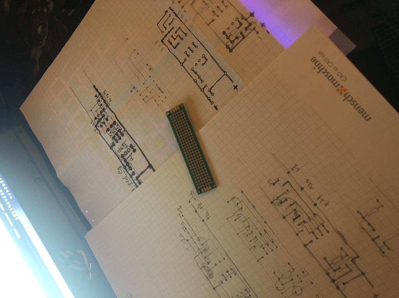

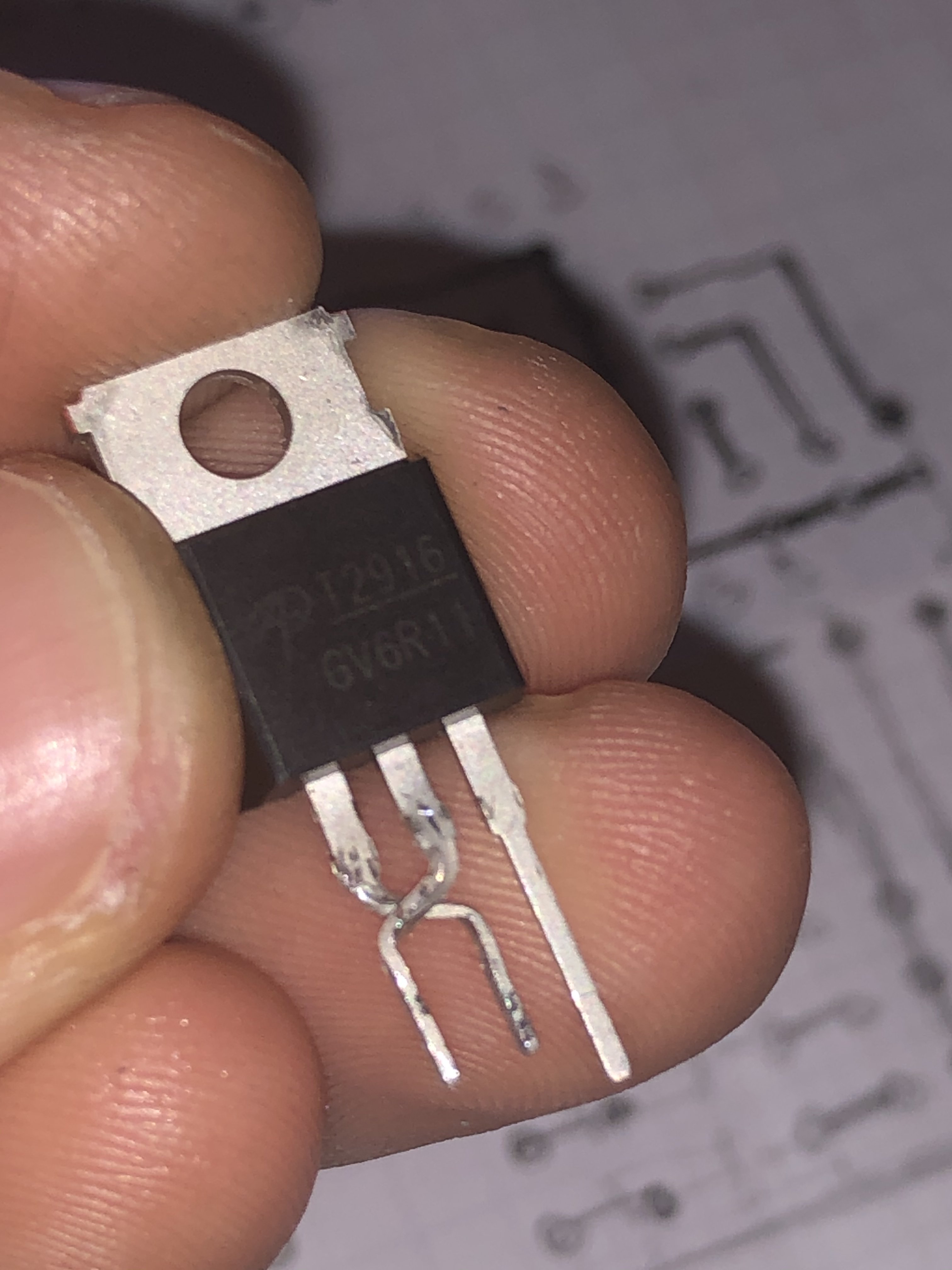

this is the mosfet i got .. i bent the legs to do less routing on the circuit board i drawn from the schematic

I do not recognize that MOSFET, not clear as to the part number. Unless it is "logic level", it may not work properly with the PIC. You have to make sure about that MOSFET, what kind it is, what the actual part number is. If you ordered it, what part # did you order? If it is a AOT2916L, then you are ok, it will conduct well at 4.5V Vgs, and will probably handle the current ok.
Another comment, the unused pins (2 and 3) should be either held low or held high by some 10k resistor. Pick which is easier (high or low), but it will keep those pins from floating and possibly causing problems.

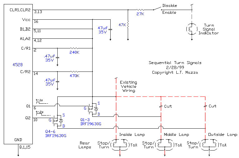

let me know what do you think about it ?

So you want audi style indicators.
The second circuit shown looks as though it'll work at first glance.
The first lamp will light immediately, the second after 1/2 a sec and the third after about 1 sec.
To change the times you can replace the 240k and 470k resistors, for symetry the larger one shpuld be close to double the smaller, as per the originals.
You dont need logic level fets with this circuit as the chip runs at 13.8v.
Take note where there are 2 numbers next to the chip on the drawing you need to connect both those pins to the same wire.
dr pepper i've tried that schematic .. but it doesnt work .. it actually works inverted .. the led strips turn off at the designated time ... i gave up on that approach
i already done the sequential turning signals, its already on the market.. what i want to do now is make the stoplight out of 3 led strips that turn on progressively for eatch stoplight.
.. added a new schematic in post 17, and will try that after i receive all the components i ordered .. i will remove the turnsignal involvement in that schematic and wire all that to the break signal for the stoplights.
