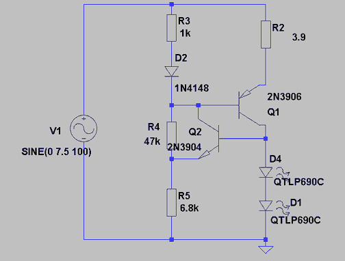

Hello,
'cause it's my first post, a big hello to everyone here!
I hope you won't throw me out after my first silly questions!
I'm looking for a constant current source with a low voltage drop!
The application:
Power comes from a bike's dynamo. Voltage is AC at frequencies roughly between 30Hz and 100Hz.
Voltage can vary (at max.) between 4.2V (climbing a hill) and 7.5V (normally less, but depends on dynamo and frontlight's current draw).
The thing I want to power are two red LEDs in series, normally they are 2V each. They'll get between 10 and 20mA.
So now I need a supply with a very low drop-out, to get a satisfactory current even at 4,2V.
Also, I'd like it to be simple! The circuit on the image is not that bad, it gives me (trusting LTSPice) 4,4mA per Diode at 4.2V and 9,8mA at 7,5V.
It's not that bad, but I'd like the current difference between high and low volatge to be lower.
Also, I imagine to use that circuit 2 times, one for each AC leg. Ok, I'll probably add a capacitor in order to reduce the flickering, but I don't have much space. I'll decide on the caps when I see the circuit in action.
I'd be very glad for any suggestions!
Dominique

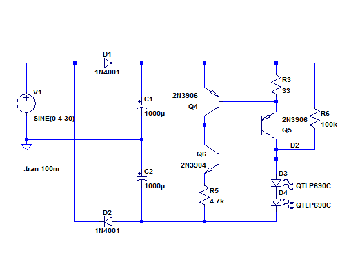

I agree that a switcher would be more efficient. Here is an idea that doesn't require one, but of course is not so efficient: (Save the code as "filename.asc" if you don't want to have to redraw the schematic.)

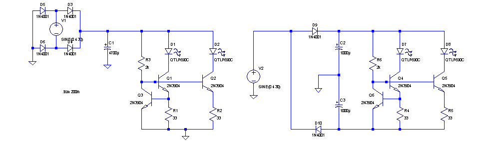

Here's simpler:
Run the AC into a full wave bridge, filter it to DC, and run each LED on a separate current source.
Each current source is a bipolar with a resistor in the emitter, bases tied together. and shunted to ground through a third transistor collector to ground.
The third transistor's base connects to one of the emitter resistors of the current driver transistors. One resistor to +V provides base drive and the LEDs are one in each collector of the CC transistors.
That should do it. Those CCs will saturate to under 1V if you use reasonably high gain/high current devices.
It's a good idea. The FW bridge was my first thought too, but it won't put out full current at 4V peak. The double half-wave circuit has room to spare at 4V, and also draws less current (which probably isn't a big deal in this case).
A thousand pardons if this is not what you described.

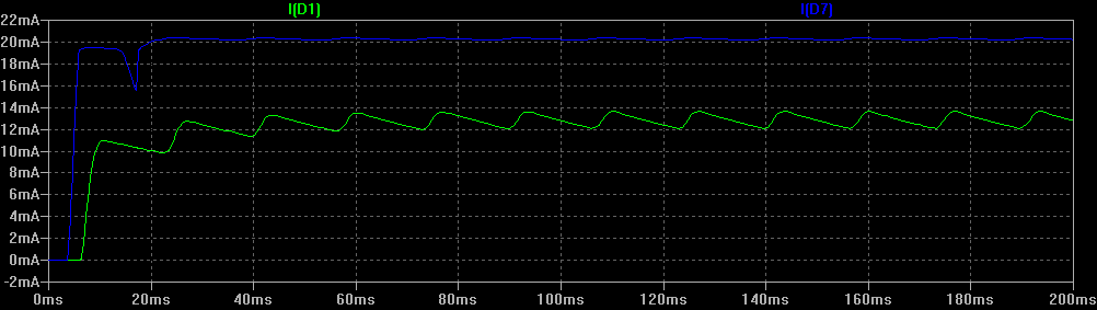

Yeah, that's the circuit I had in mind.
Maybe I'm reading his notes wrong. I was using 4.2Vrms in the sim, and it worked fine and dandy.
I went back and put in 2.97vrms/4.2V peak and got about 15ma on each LED. That may or may not be enough for the application. It pulled out of CC regulation for 20ma at about 4.7Vpk/3.3Vrms. But it was still about 15ma.
The real question here I think is what's the internal regulation of the source? If it's got a good low internal impedance, either way works - yours certainly and mine almost. If it's got say, 5 ohms internal impedance, my way sags to about 12ma and yours is just beginning to pull out of regulation. So I think the doubler is much more constant current.
It's a tradeoff between two additional diodes to make a bridge and one additional capacitor for the doubler, with better performance on the doubler. The FWB will be fine with 1000uF, so the caps can be the same size as well.
