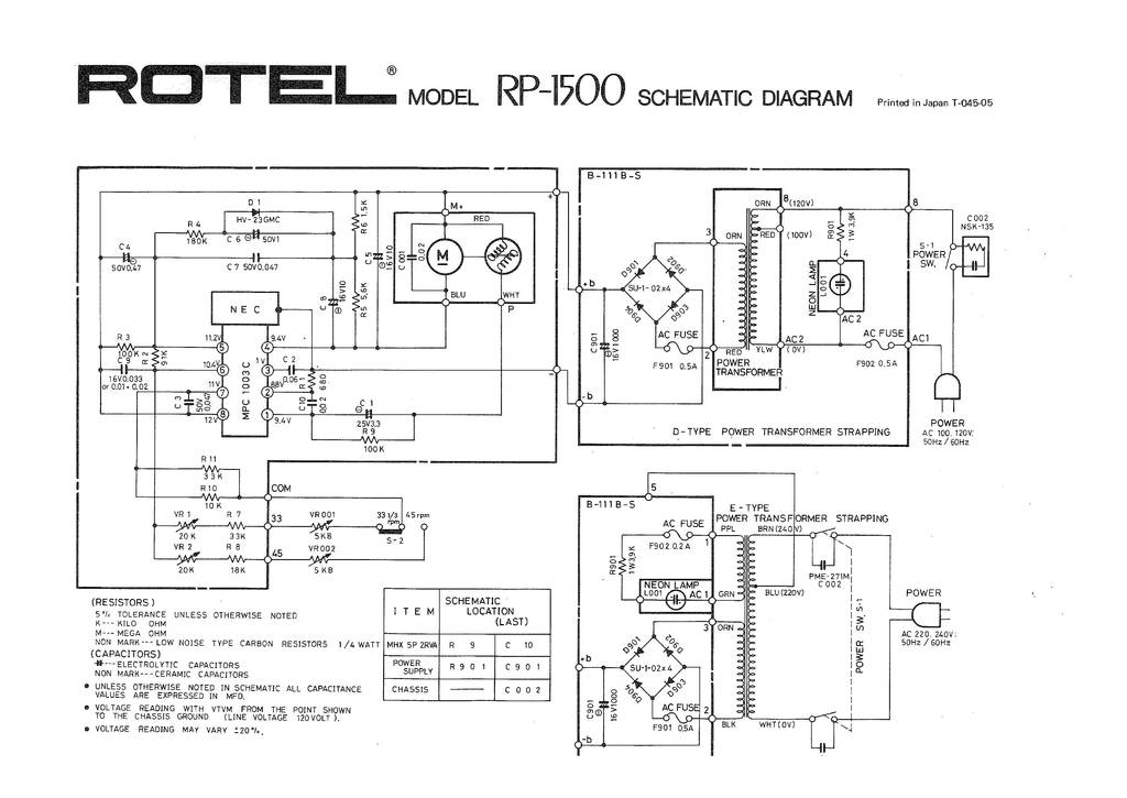

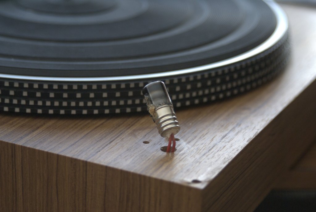

I'm not an electronics expert by a long shot, I'm just trying to find a suitable replacement for the strobe lamp for this turntable. I've tried Rotel but they said as it's 40 years old they couldn't help.
I have a picture and the schematic, I just need to figure out how to add those to this forum!

That neon is connected directly to mains voltage if the transformer has the D-type strapping. Having it's terminal(s) exposed as shown in the pic is potentially dangerous.
Safer to use LED illumination. A pair of back-to-back LEDs (with suitable current-limiting resistor) could connect to terminals 2 and 3 of the power supply.

I'm not using the turntable like this, It normaly has a cover over the lamp which i removed for the purpose of the photo.
I have read that the LEDs aren't quite as good because they don't flash on and off as well!?
I have followed this up on the ElectronicsPoint site.
Look on eBay USA under Russian neon lamps. These are the E 10 fitting, you should be able to find them. Don't get Chinese fake copies.
