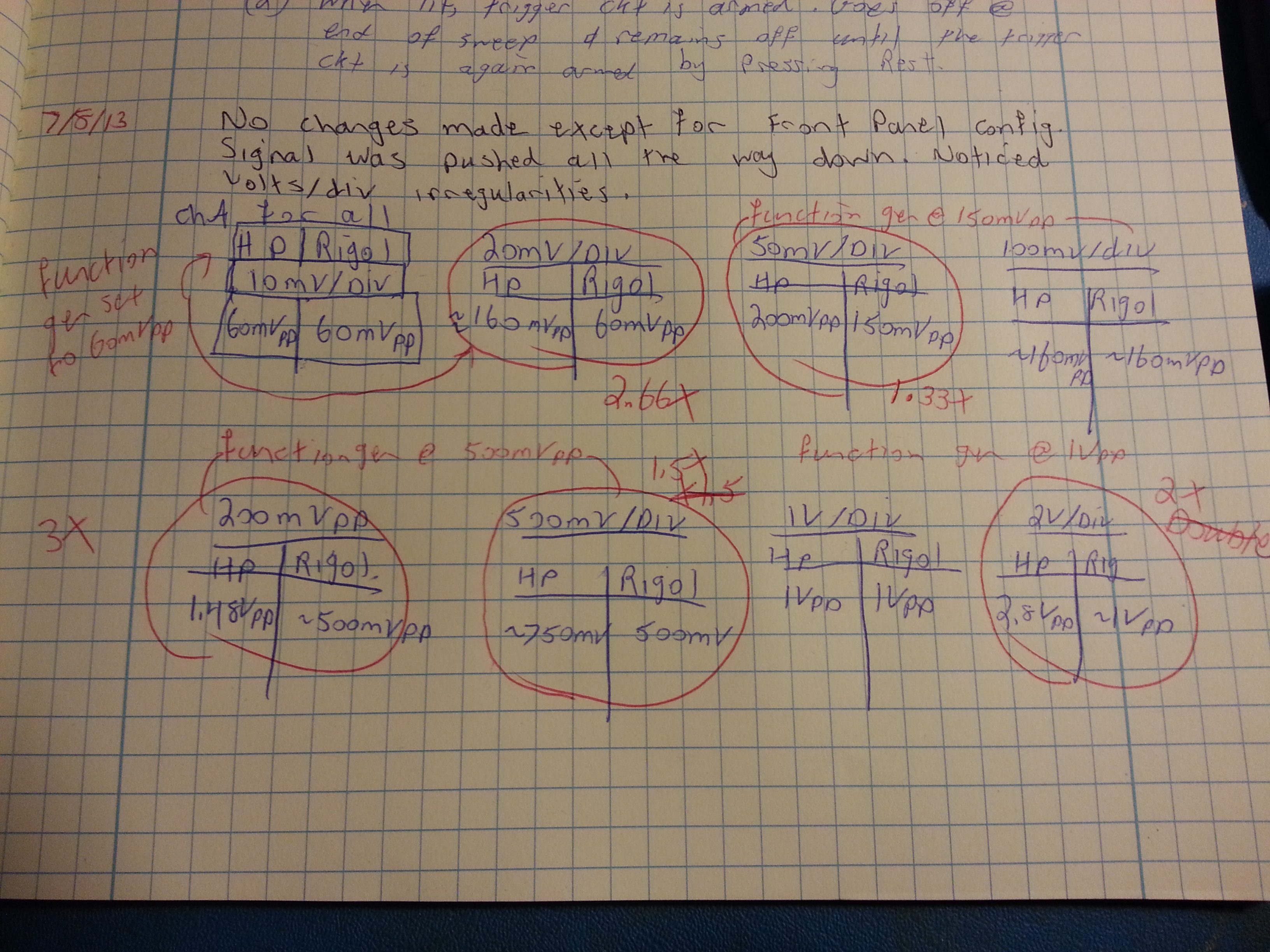

I noticed channel A's volts/div when changed from say 1mV to some higher gain, the display would show a signal larger than what it actually was. I noticed this on several different positions, as it would be 1.3x, 2.6x, 2x off. That will be my next thing I will tackle this evening when I get home. Channel B appears to be working just fine though.

Knobs typically have a cal position. Usually it's the inner part of the volts/div. Typically there is a light that's labeled cal or uncal and the cal position is full counter-clockwise for calibrated. There is usually a click associated with cal.
Lissajous plots is one reason to use uncalibrated.
The cal knobs were all locked in the cal position. I recorded the values last night (see pic below) and compared it to my Rigol.
I own two HP 1741A which are essentially similar to the 1740A other than they are storage models. The sweep amp caps are known to fail as are numerous switch contacts needing cleaned. First assure all the controls/switches are thoroughly cleaned as most often it's just that at fault. You claim B channel works fine so you have a working section to compare measurements to from Chan A. Those are aging scopes by now and again more often than none, it's oxidized contacts and some of nthe sealed pots at fault. The 1740A and 1741A are amongst the finest o'scopes ever made during that era, surpassing the Tek scopes. The HP CRTs were excellent. The build quality and design is what's made them last so long and it's those two models that forced Tektronix to relook at their line of scopes due to a drop in sales. One of my 1741A scopes was lab calibrated in 2011 which is pretty rare for an eBay scope! I also have a Beaverton-era Tektronix 475A (a quality, workhorse model) and I will take the HP over the Tek any day- it's that superior in numerous ways. You've got a good scope worth repairing.
'scopes I've owned have all been squiffy with switch contacts, often causing faults, invest in a can of switch cleaner, switch cleaner - not wd40.
Its unlikely you'll get the same fault on both traces, so if both sides dont work then maybe (not allways) the fault is somewhere else.
